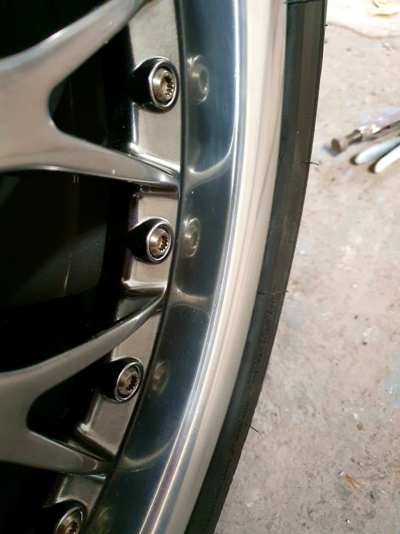

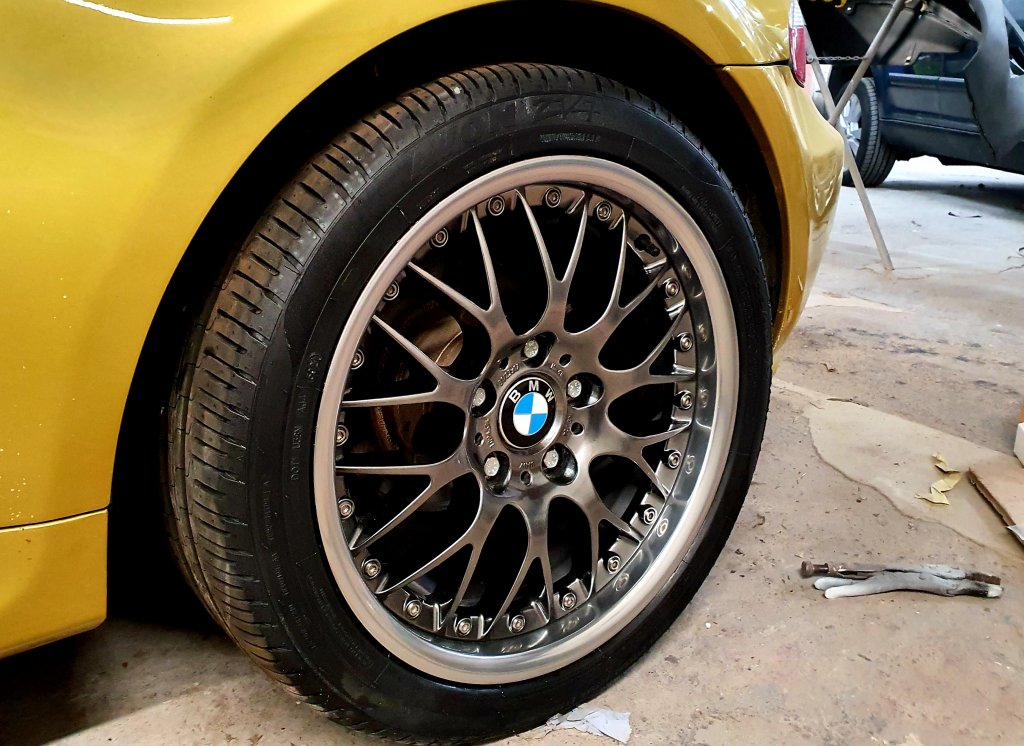

I spotted a set of split BBS wheels on FB, the guy was selling his 3.0l Z3 and I could see the wheels he had taken off in his garage, I messaged him in June last year to see if they where for sale, I didn't hear anything until November, worth the wait though as I got them for £100 🤣, I have polished the rim and use high adhesion top coat on them, the centres have been done in light shadow chrome, I was never happy with my original set as the shadow chrome is almost black,the guy lived in Telford and mentioned that he had met Niall, @Nodzed, I think his 3.0 was black, I also treat the car to a brand new set of Avon bootsView attachment 215959View attachment 215961View attachment 215959View attachment 215961
You’ve done an excellent job on those wheels, they look great. I know only too well how difficult they are to refurb having had many sets myself and for £100, are you related to Dick Turpin? =)) 10/10.

I thought getting a spare set of style 55 wheels with tyres for £50 was a bargain- but yours for £100 smashes that!

The set I have on the car right now was a bloody nightmare, I snapped ten bolts whilst splitting the rims, on this set I used an impact wrench rather then a bar, I only snapped one and got it out with ease, I have seen these wheels go for a grand
When splitting the bolted wheels, they need to be heated in an industrial oven, this stops the bolts from snapping in 99% of cases. I’d say your wheels are definitely in the £1k bracket.

I should have said, we have an oven that we bake cars in after they have been painted, I baked them at 70c for 40 mins before I split them, I have done quite a few sets but the set where a snapped ten was pretty bad, I have set of 108s that has been sat in a corner for 3 years, when I split them I did the first 3 and only snapped 2 bolts, I got the the fourth and couldn't get one out, everyone either snapped or rounded, they must have been bonded in with some serious lick tight
