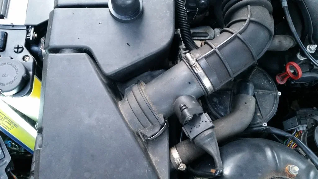

Looking at the pictures posted on here I guess all the engines are M44 or similar where the oem filter/housing is taken out and the cone style filter just just pushes on.
On my M43 engine I can remove the OEM filter and housing ok but there is also another pipe running from the airbox to the emission control air pump which also I guess needs a filter on it or some kind of adapter pipe to work.
Has anyone done this on a M43 engine?
Its the least of my worries at the moment ., but I do find it easier checking/working on the car without the huge air box in the way.
from my old M43 pippercross
home made heat shield on the pics but then a pro one installed later...cold air feed from the side of the headlight

@swamper .
Thanks for the pictures.
That's the way I was thinking of doing it as well with the small filter on the air pump rather than taking the airpump and all the electric sensors out, the way you have done it means if I have issues it will be a quick swop back to OEM
I do believe that on the M43 engines if you start removing the air pump it flags up codes which then have to be masked. I may well be wrong.
Its good to see someone has done it like that and caused no issues.
Thanks once again:thumbsup:
Removing that smog pump won't give you any problems whatsoever. If it's the same as on my 2.0 there is an electrical connection for the motor and one vacc pipe which you plug up.
I wish it was that simple on the M43 Tony.
When I was over stacey and martins at the weekend we had a look at it. I think it's very different to the M44. Several pipes and sensors are attatched. When we did a search on the net to see how to do it it threw up several issues with code errors etc.
Ok, sorry my info no help mate. Hope you find a way round it.:)

just go for it DD,,,its easy and makes the engine bay much more user friendly
Is it a simple remove Wayne? I think that's what's worrying him mate.
swamper
Dec 4, 2011
181
Bacup
M
all the air intake....?
if so yep....its stupid on the M43...theres a pipe that runs over the rad!!
start unscrewing and its off in minutes
It's the Aux air pump which is worrying him mate, on my Z3 it was two bolts to dismount the pump, two nuts to remove the vac capsule off the head, blank that off, plug the vac pipe and disconnection electrical cable.
