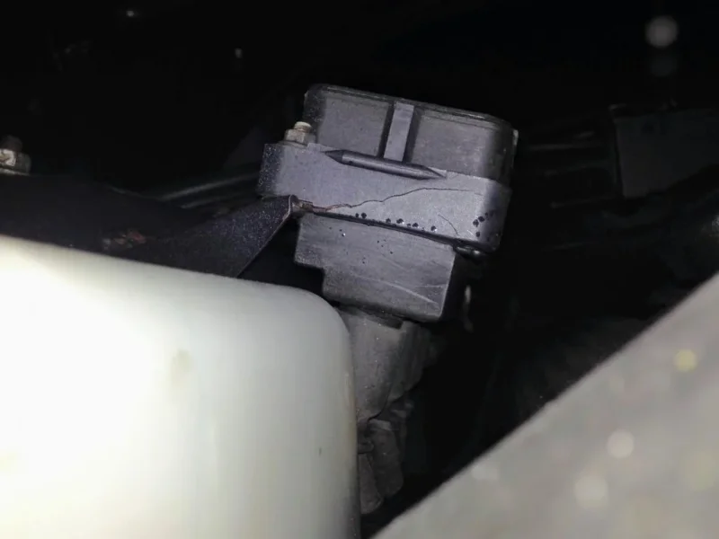

However, following further discussion, and refreshment, the question of misfiring in wet conditions led me to inspect the ignition coil pack on my car more closely, with this result:
There are two cracks at the front of the casing, right where the fan would throw any spray coming in through the radiator or the air slot in the bumper below, especially with no fan shroud. We looked at Ray's car and his coil pack has an almost identical crack in the casing. So, with a Bosch replacement costing £65 or more, I think that I shall give the casing a good clean and invest £6 in an aerosol of good old fashioned Holts ignition seal. It goes against the grain, as I'd prefer to have things all clean and free from any coating, but it worked very well at keeping the damp out of my Mini and A35 distributors and ignition leads fifty years ago, so it's worth a try now for the same job. I can always clean it off in the dry season! Whenever that is!

I would be inclined to open up the cracks with a dremmel type tool and fill with an epoxy glue.

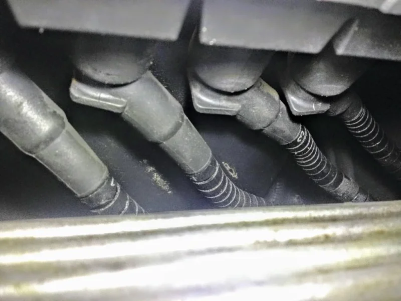

It was cold the other morning and when I set off out, Ratty had another few moments of misfiring until the engine had warmed up. On return and on further investigation and cleaning of the coil pack and ignition leads, I noticed that numbers two and three were touching the bodywork of the suspension turret. And the paint is corroded in the place where the leads touched it.
So I reckon that when damp, the leads could have been shorting to the bodywork. So I have cleaned it up some more and twisted the lead connectors under the coil pack so that the offending leads aren't touching anything. Since then with more cold and damp, it hasn't misfired at all. So I'll have to see what happens.

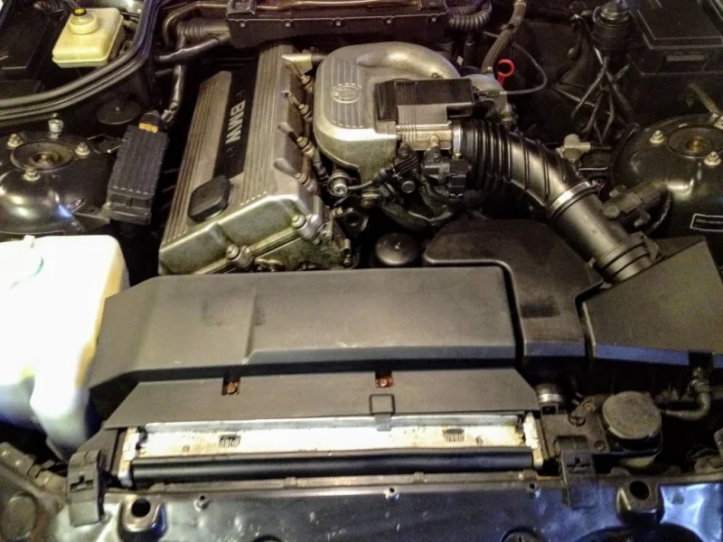

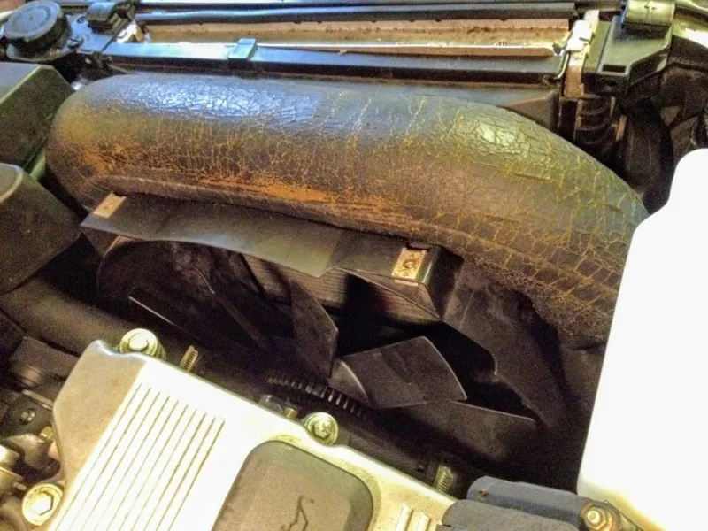

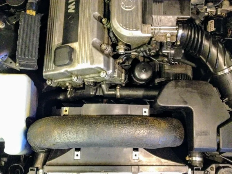

Today I fitted the cooling fan shroud which I received as a Christmas present. When I got the car, this was absent.
First I attached the shroud itself to the radiator. Then I fitted the insulated air intake tube, passing over it from the intake to the filter unit.
Then I bolted the top bit down to hold the tube in place.
I'll need to clean the rusty bolts! The plastic is over twenty years old, and may have lost some of its plasticity and become a bit brittle. As a result, the top mounting lugs had broken off, and so I used two cable ties through holes drilled in the top corners. But the whole thing seems firmly fixed to the radiator, so I think it should be ok.
