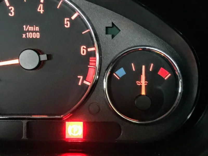

Thanks Tony. Do you reckon it's ok to drive it on short runs till I've replaced it?Yep, sounds like a new thermostat is required.
Great, thanks Steve. Sound advice! I shall check hoses.If jammed open just wont heat up .
If you run the car a few minutes then check the top and bottom radiator hoses if both about the same temp thermostat jammed open for the small additional cost i would do water pump as well prone to fail especially on viscous equipped engines.
Stephen.
Sorry for late reply Paul we've been out all day till just now. But, yeah what Steve said.Thanks Tony. Do you reckon it's ok to drive it on short runs till I've replaced it?
