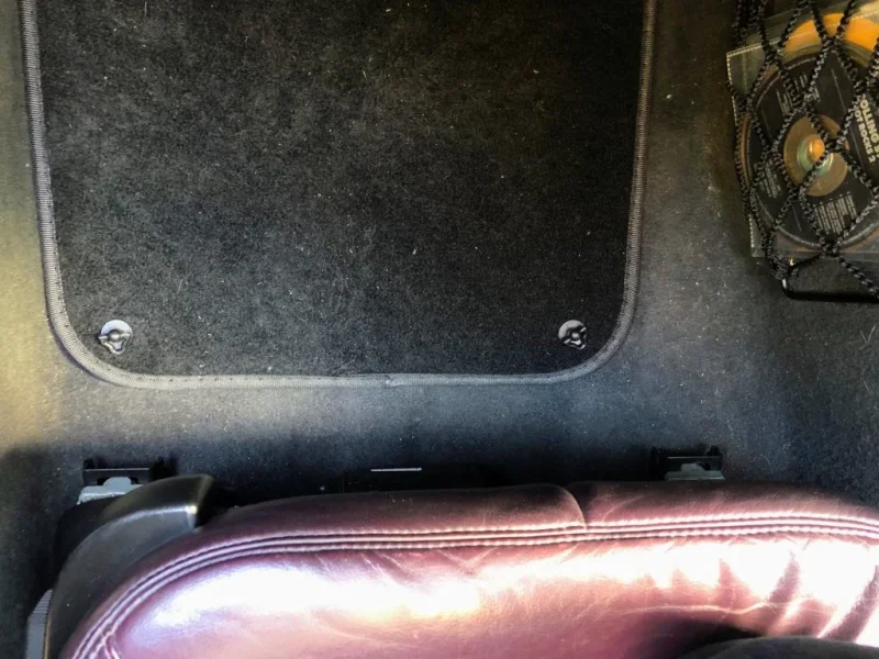

Well this a progress thread, so ... for the last three years and 25k miles of Z3 ownership, our floor mats have always made their own independent journeys, creeping off in all directions, as they had just one fastener between them (on the driver's side of course.) So, with great thanks to @spurs fan in a coupe for supplying three more fasteners, their journeys are now going to match all the rest of the car, and they won't go wandering off.

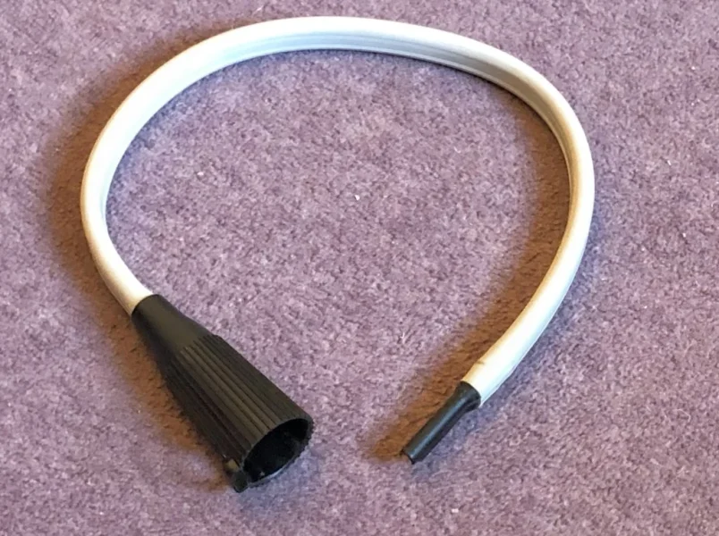

And Sara found me a very handy item in a charity shop for 50p:
No, it was in a charity shop, not a sex shop, nor a shop selling medical appliances!
It's very good for getting down beside the seats - it will even pick up coins.
