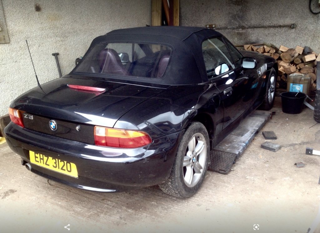

Lots of fettling to be done, but I'm borrowing the lift to make it easier to get the polisher on it!

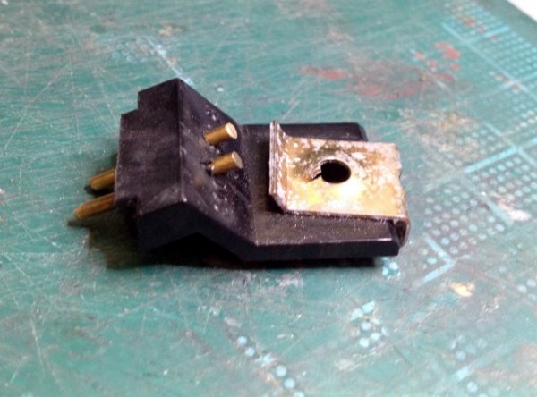

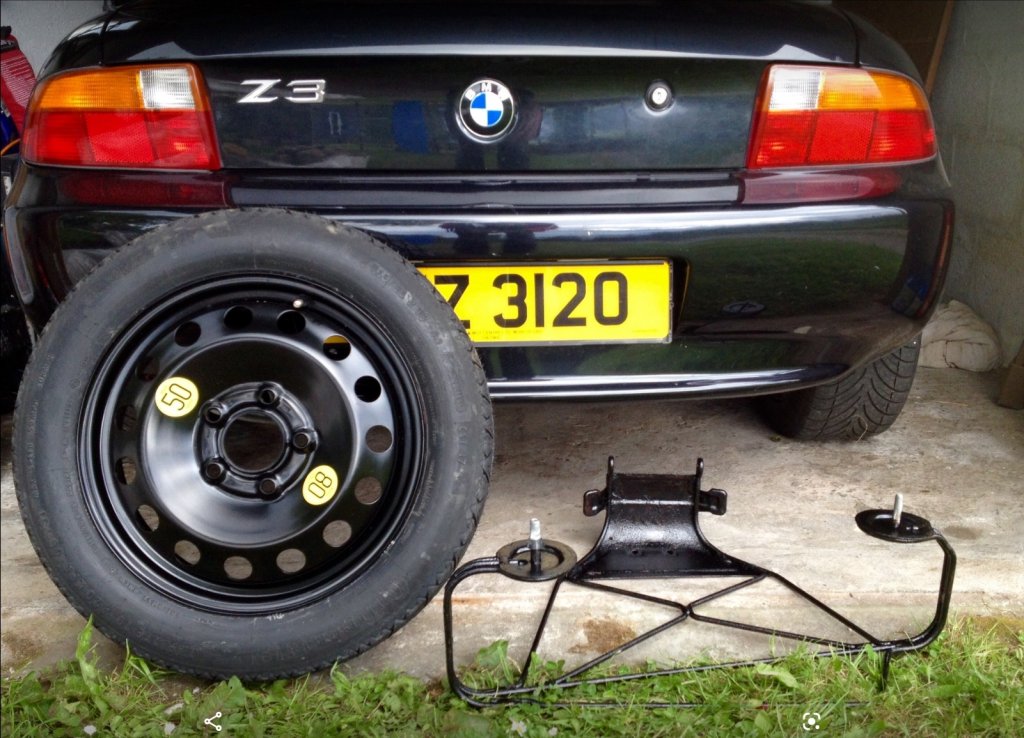

After some discussion, I've decided to invest in a) some OEM hoops, and b) a space saver spare wheel. The former, because we've grown accustomed to the reassurance of driving a Volvo, and anyway they look good, and the latter because much of the Highlands lacks any mobile phone signal to summon assistance.

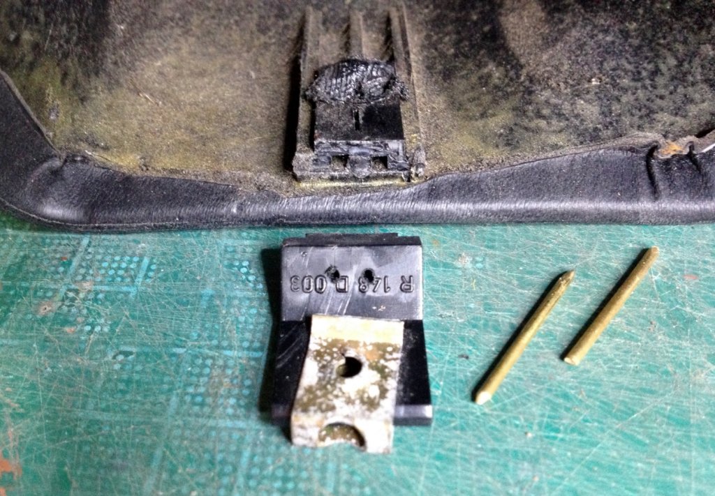

The hoops and the wheel arrived today., Probably as a result of me managing to drop one end of the large box with the hoops in, one of the plastic screw fixing lugs was broken off one of the top trim bits. Nae bother, I drilled the lug with two 1.5mm holes, pushed in 1.6mm hardened brass rod pins and Araldited the lug back in place.
Screenshot_20190617-182204_Photos.jpg Screenshot_20190617-182234_Photos.jpg Screenshot_20190617-182308_Photos.jpg
Job done. That should hold.
The car had come with no spare wheel or plastic tray, but I took the metal cradle and wire brushed it with the drill, then Hammerited it.
All ready to fit when I can sort out the fitting nuts and bolts in my cousins shed tomorrow.

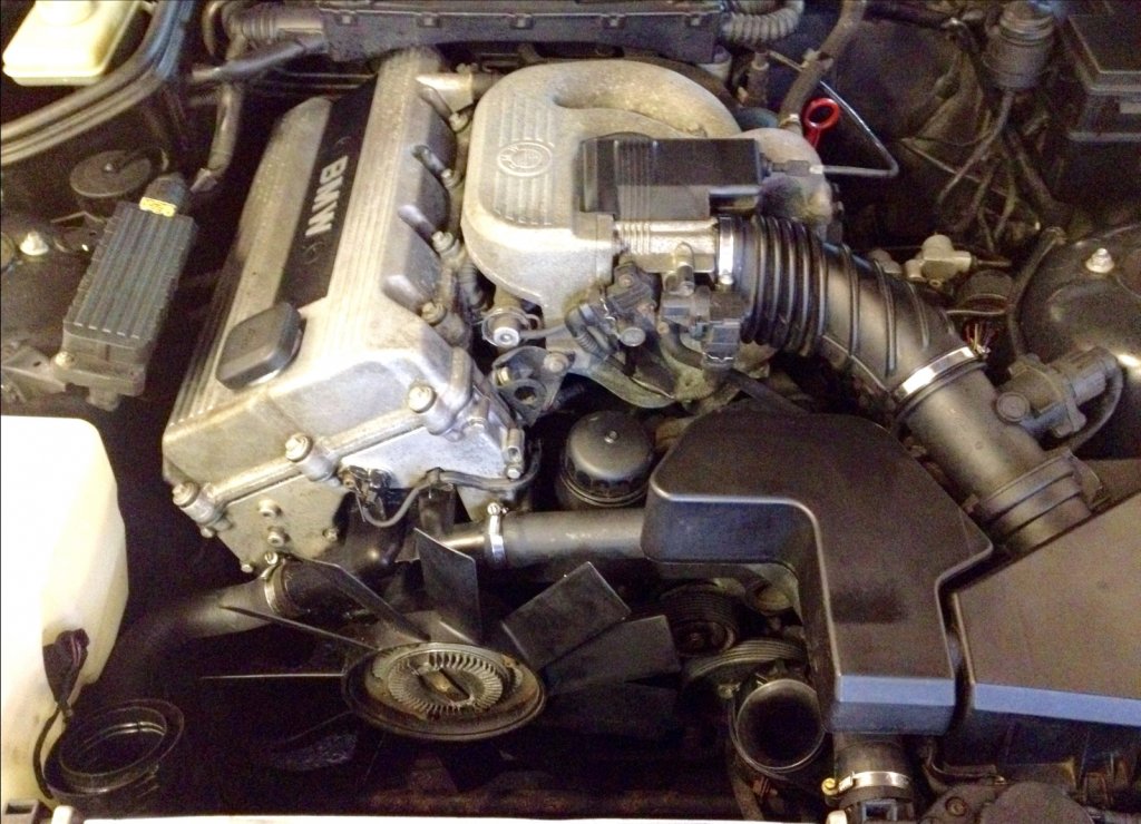

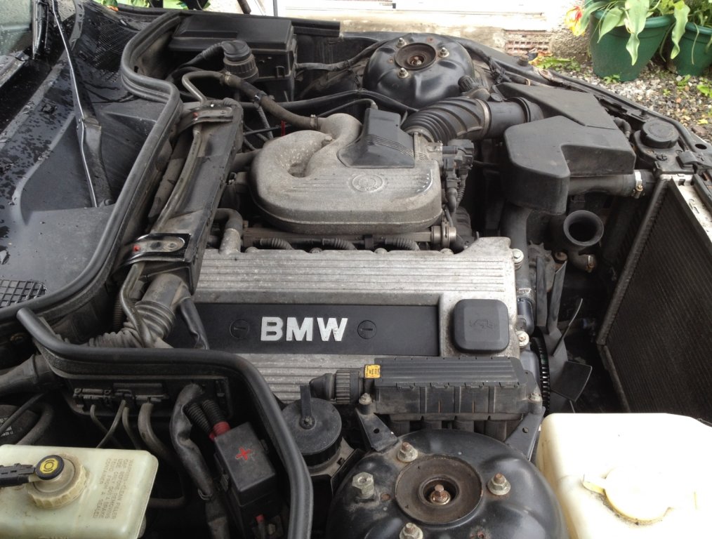

Meanwhile, I've started to clean up under the bonnet a bit.

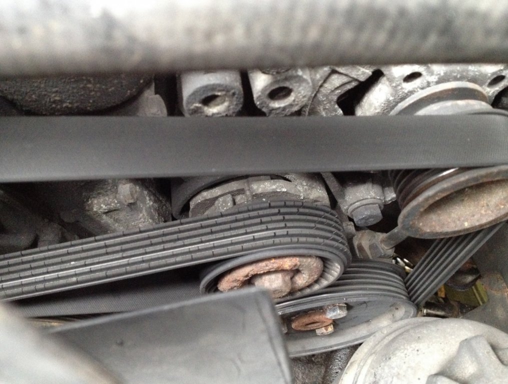

Thanks Jjim. The wheel carrier and the fan belt are fitted. I love the BMW belt tensioner/idler - five minute job!

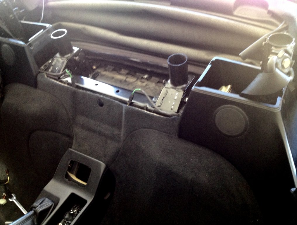

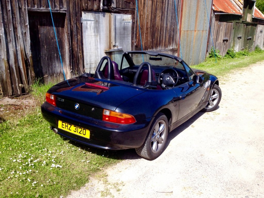

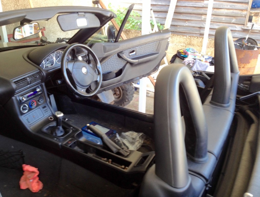

Busy day today, as I fitted the hoops (thanks Sean) and the wind deflector (thanks Lee). Yesterday, the car looked like this,
At Cromarty as the Sea Cloud 2 motored out of the Sutors and into the Moray Forth, not under sail unfortunately. Very reminiscent of the ships taking Highlanders to the New World sailing from Cromarty during the Clearances of the nineteenth century.

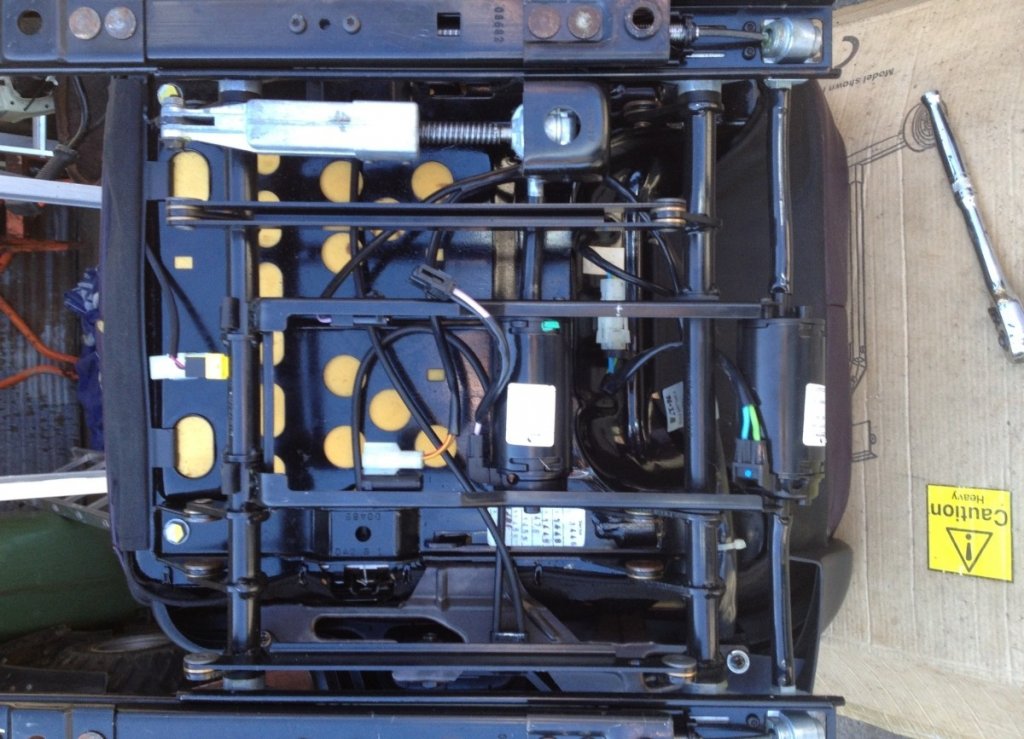

The passenger seat was stuck in the up position, so I took it and the drivers seat out to fit the hoops. Having unbolted them, and then disconnected the battery, the seat wiring was disconnected. With the seats out, access was much easier.
The threaded bar at the top had been jammed at the end of its travel, and was freed off by undoing the bolt holding the forked end of the aluminium body top left, and winding it down the thread before reattaching it. The motor and the drive into the right angled gear box worked fine, but no drive came out of it, so perhaps the threads on the worm gear inside had been stripped. Something for replacement one day. In the meantime, with the seat set lower, the passenger will be at a more comfortable level.
So, following the comprehensive BMW instructions downloaded from http://mz3.net/retrofitting-bmw-roll-hoops.html, the necessary parts were removed, and the chunky 'console' fabrications that hold the inner hoop legs were bolted in to pre-existing nuts fixed to the body.
Then the hoops were inserted and the new storage compartment was fitted and the hoop fixing bolts torqued up. The remaining trim bits were fitted, and the job was nearly done.
Somewhere I read that retrofitting the hoops was down as a 5 hour job by BMW, and Ray and I took 6, including an hour lunch break, so we were quite pleased.

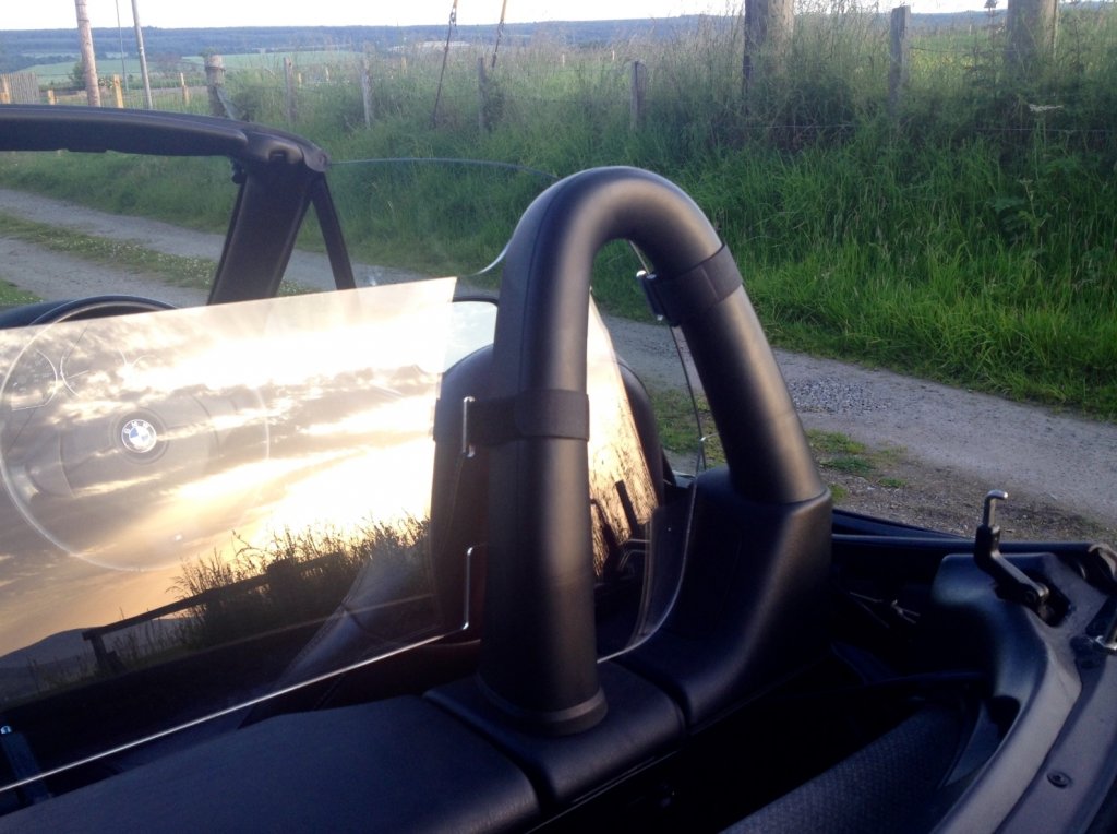

This evening Sara and I went out for a run to Rosemarkie to see what difference the clear acrylic wind deflector made.
And it makes a big difference, with less of a draught on the side of the neck, and less buffeting, so that's a result too.
It's fairly inconspicuous, and doesn't spoil the look of the hoops too much. And this design from Lee doesn't preclude the use of the storage compartment either - it limits how much the lid can be opened, but it allows a Galaxy tablet, CDs and so on to be put in and taken out easily.

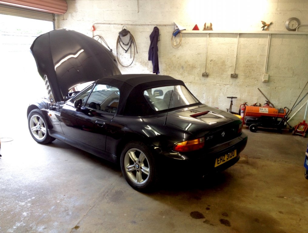

After cleaning and proofing the hood courtesy of Autoglym, it was time for more effort on the bodywork and engine bay,
Using Ray's workshop let me get all round the car, unlike in my own little garage.
It's getting there slowly. The wheels, which Ray stripped, primed and sprayed, came out rather well, and I'm now going to keep them, rather than replace them with the pepperpot originals.
