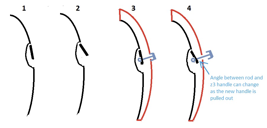

I think I know what you mean. The rod wouldn't be welded/screwed rigid to the z3 handle. It would be attached via a bearing or hinge that allows the rod to swivel. The rod comes out at a fixed angle but as it moves the angle between the rod and Z3 handle can change.
Looking at door from this angle
1. Original Z3 handle in the closed position.
2. Pull the handle out and up to open the door.
3. Red tribute door skin over the door. The grey is a pull handle. Sorry. Not a very good representation but I hope you know what I mean. It's attached via a rod to the original z3 handle.
4. Pull the exterior handle which, in turn, pulls up on the original Z3 handle.
The rod isn't fixed rigid to the Z3 handle. There'd be a roller bearing behind the z3 handle.
The drawing is excellent :)
I think you will be ok if the Z3 door release is triggered at an angle similar to 4. If it is much more, you may have problems.
The only way to find out is to try your design. Nothing ventured...
I've probably got two ideas in the bin for every one that is on the car, so I've done plenty of venturing 🤪

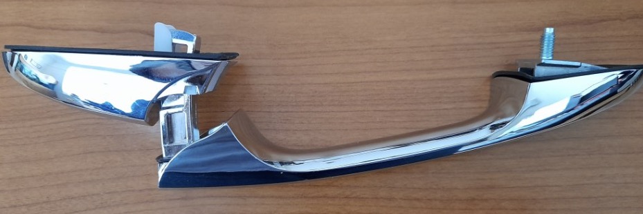

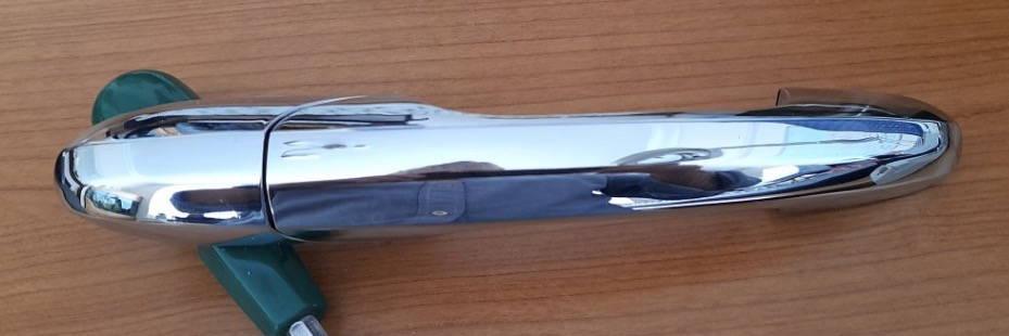

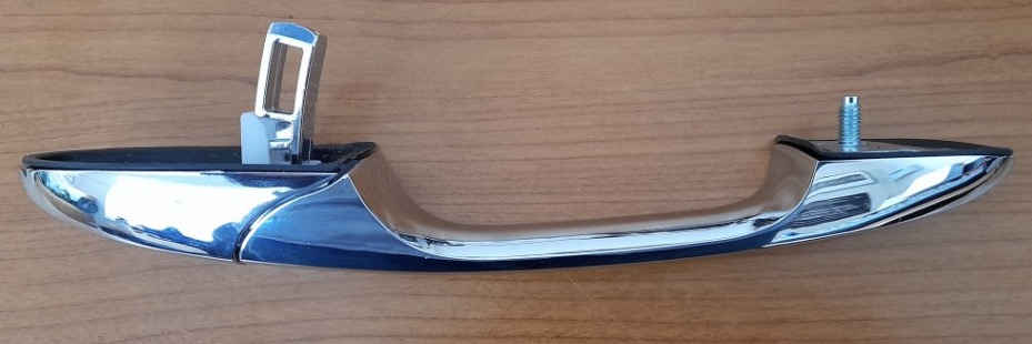

This is a handle I might try. Just received it today.

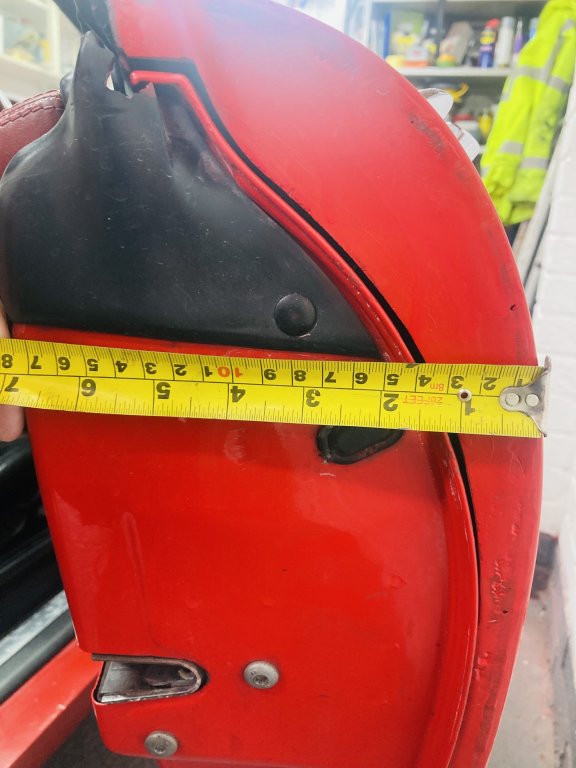

I've got a flat sheet of fibreglass. I'm going to fix it to the door of my Z and guestimate the distance and angle from the steel skin and fit this handle to that 'skin'.
The door handle on the Z3 moves quite easily up to about 45 degrees without anything happening then another cm against some resiistance and the door clicks open. I'm thinking of fitting the handle a bit higher up the door than in my diagram so that there's an even pull at that last bit of resistance.

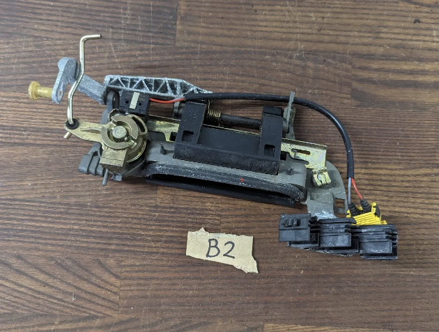

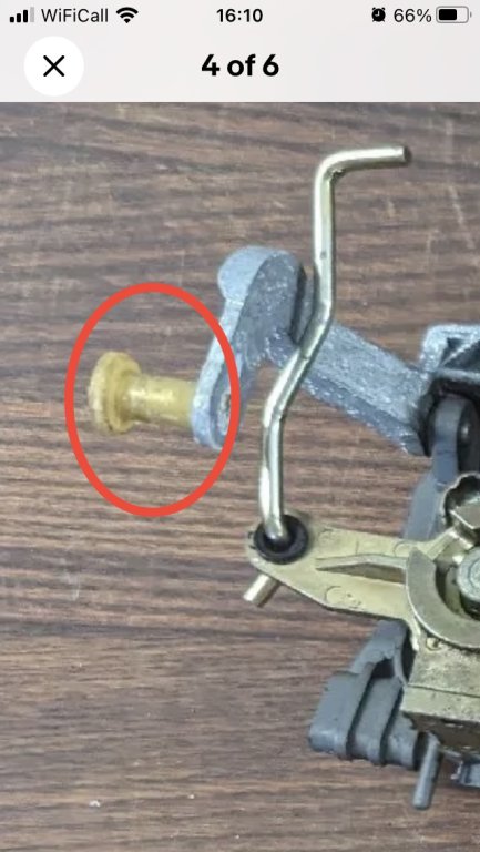

The original handles act on the lock. The bar which operates the lock originally had a plastic sleeve where the red circle is, it’s missing here.
By adding a new tube over this section you remove alot of slack from the handle operation, so the movement you have before it starts working is due to this sleeve having disintegrated and fallen off years ago.
I discovered this when I had the handles removed
They look very nice, but three observations...
How does the rear part attach?
The nose looks like it would go into the door skin when you open the door. Am I wrong, or have you thought about this?
The handle doesn't open in a straight line. Does your design compensate for this?

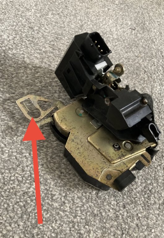

If this lever does not fully retract, the car will not open using the central locking. The Alfa handle had approx 10mm Push which is not enough to allow the lever to go back.
The herald has about 16mm push so works well
jaguartvr
Jan 9, 2017
95

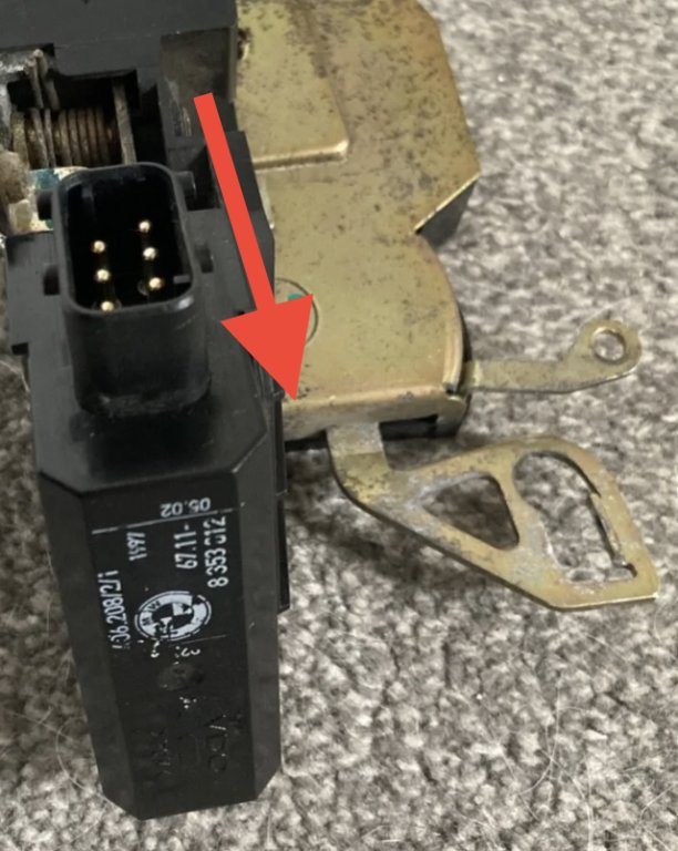

That's the bugger, an absolute nightmare to get your fingers to but this is the lever that must be lifted to unlock a deadlocked car.
Can you post a picture of the other side of the lock as it will explain better where this part of the lock is positioned.
