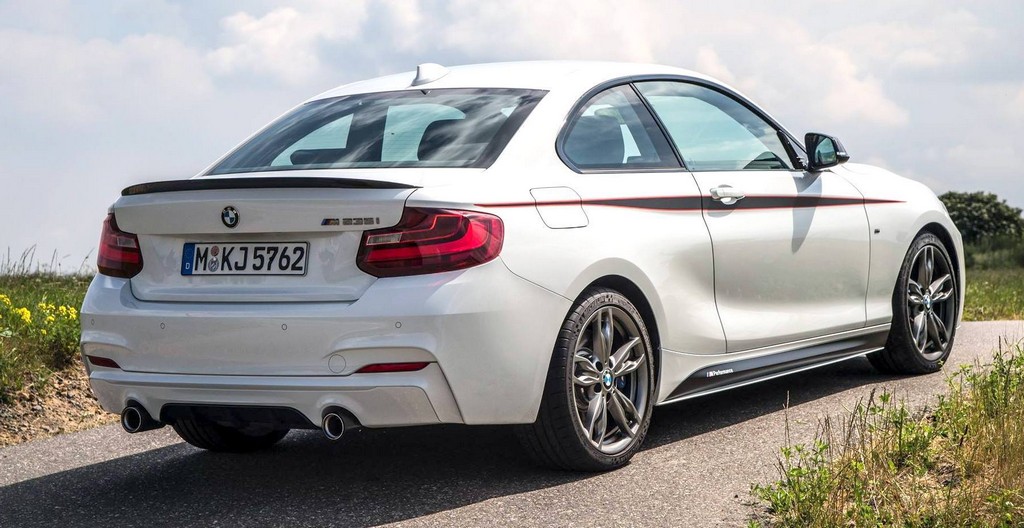

Bavarian have a m235i in White with the M Performance kit which looks really well, just like this.
