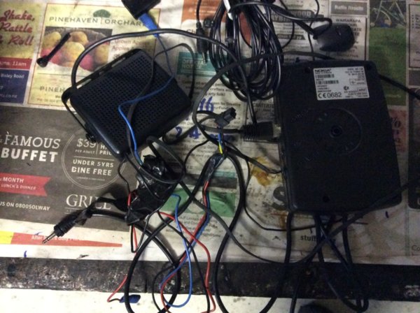

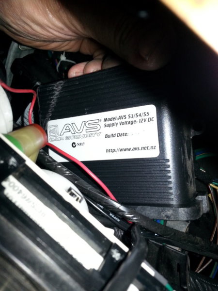

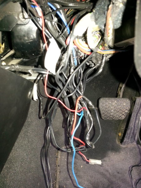

Some success today :)
1. I found a black module marked Nokia lying loose under the radio, so I worked out the sensor by the mirror was a mic, and the little speaker in the drivers footwell was for this. All these items and related wiring are now removed.
2. Having removed the Nokia stuff I noticed another module lying loose under the radio, and this turned out to be the alarm, the company (AVS) that fitted it is still in business and I can buy a new remote at a rather high $99, or better still I’ll work out how to remove it, or at least stop it immobilising the engine.
FRom the pic you can see the alarm wiring is a real messy job of black wir3s spliced into the bmw harness.
So, I think I now know enough to resolve the issues of not having spare keys/fobs. I think I will have a go at making my own key from a used infrared one, as I certainly won’t buy a new infrared one from bmw at $300.
I rather fancy still having the remote/keyless option on two keys for the car, rather than buy the non button key from bmw as a spare.
Some pics.....

Alarm is out, in the end it was quite simple, the alarm immobilised the car by acting as a switch/relay in 2 of the thick wires in the ignition circuit. It did not make use of immobilisation function provided by the EWS or DME.
There were wires spliced into the bmw harness all over the car (door locks, interior light, boot, bonnet sensors etc etc) but I was able to remove them without taking too much of the interior apart. A short length of each the 2 main ignition switch wires by the steering column was cut out to insert the alarm in the circuit. Joints were just soldered then wrapped in insulation tape. Horrible to do that on what was quiet an expensive car back when it was done circa 2008 :banghead:
I had forgotten just how “cowboyish” the alarm fitting companies can be!
