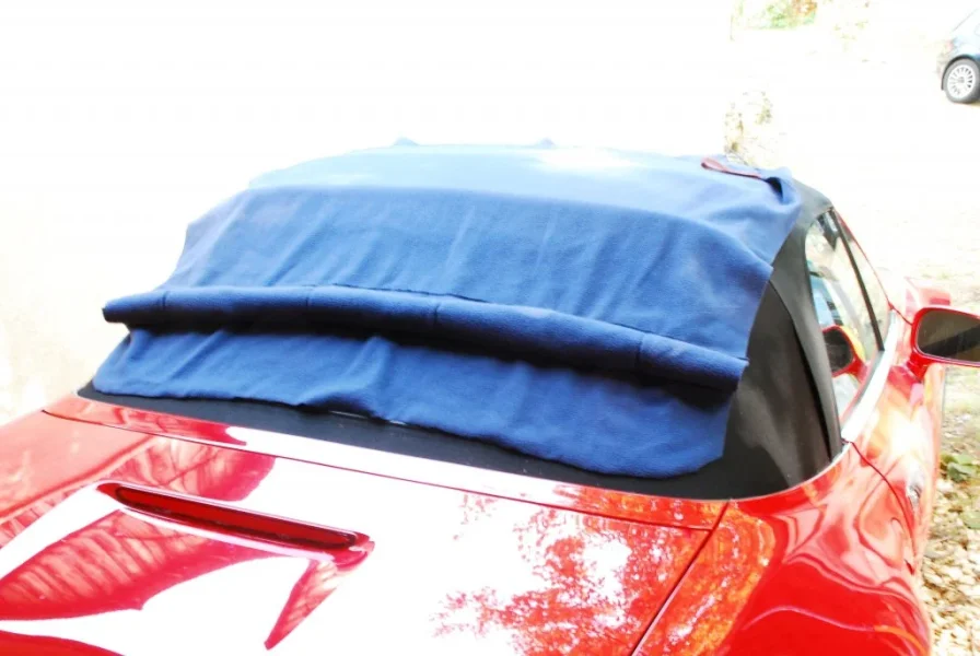

A good way to prevent scratches on the rear window is to always brush any grit or leaves from the seam above the window before lowering the roof. This is the cause of the usual mark across the half-way point of the window.
Another good dodge is to use a hood blanket of some kind. The BMW version is made of very thick felt, which provides a decent bend radius for the window, in addition to reducing con tact and polishing between adjacent area of the hood.
The problem is that it is bulky, so I designed one made from a fleecy blanket, secured by a short velroc strap above each window, with a tubular pocket to hold 4 short pieces of foam pipe lagging. It therefore folds up nicely, and also doubles as a pillow when camping!
