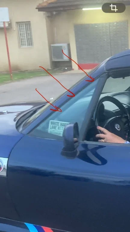

My door was just fixed from a recent knock and I now seem to have whistling from the front end of the door window.
Is there any play in this where I can improve the pressure of that area of the door on the rubber strip?
See attached pic
The fix was to release then 10mm bolt under the door which is connected to the bottom of the A pillar. Then push it out about 1mm - such that the top corner of the pillar pushed closer to the top weather stripping when closed.
