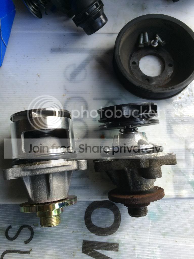

Fitted the water pump and new thermostat this afternoon and as expected the water pump I took out was in excellent condition even though having a plastic expeller !!! The whole job only took about hour and half but I was lucky everything came off easy.
You can see the difference in the pumps and the one I took out was the original and done 76k and still perfect
Piece of mind knowing its done and it was a joy to do.
