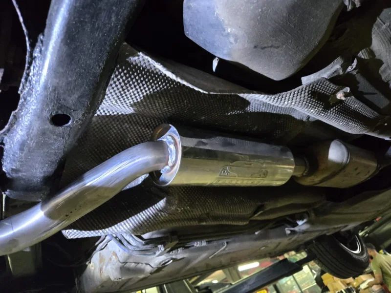

Got her up on the ramp and initial inspection showed that yes we 'could' slap a new back box on there but the pipe was original and it might snap over time - also as you can see going back to the resonator it was all pretty ugly - from the resonator forwards was decent - original pipework all pretty solid and the CAT looked OK as well. So I'm now on the hook for a new resonator, back box and associated pipework. The original quote went from £220 to £450 for the additional work - frankly still reasonable money for what I was getting.
the guys cut the pipe off and as you can see - pretty ugly but bless her for 26 years and 120k miles decent life expectancy - RIP OEM Back box you served me well.

Here's a couple more shots of the work from the replacement resonator to the new back box
All in all I'm happy with the work, she sounds awesome without being stupidly loud, will sail through MOT and emissions testing etc all good - the pipe was welded but if it lasts even half as long as the OEM fair enough - I only do a few thousand miles a year should be fine for the foreseeable.
