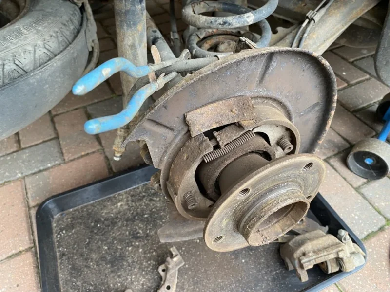

So far this morning the rain has thankfully held off so I'm at it

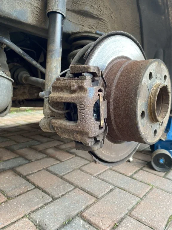

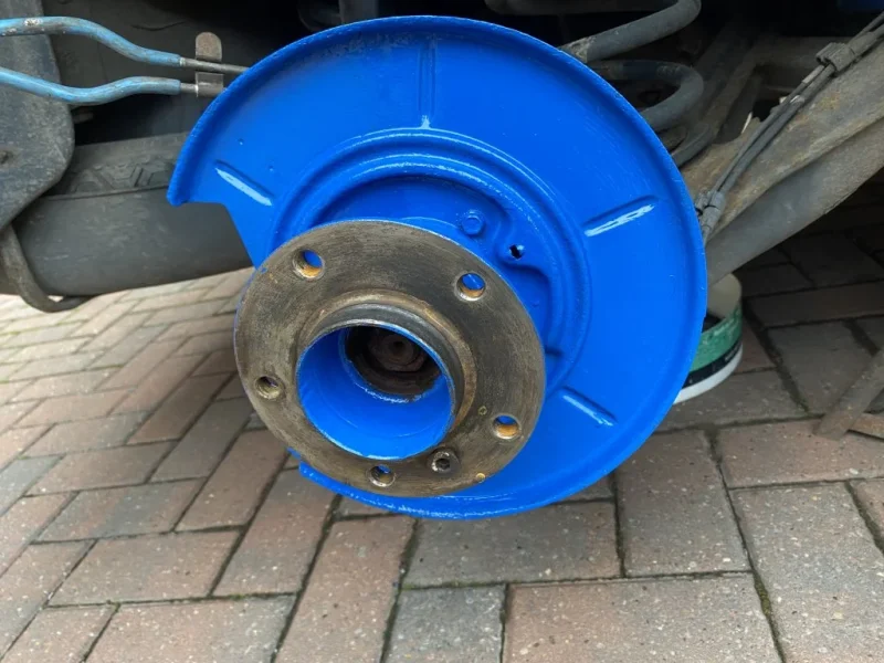

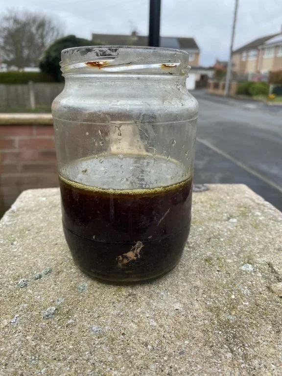

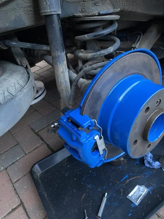

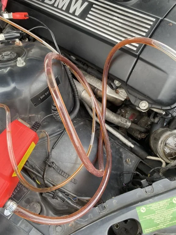

I built up the nearside then it was time to bleed both rears. I removed the present brake fluid – Have you seen the state of it?
It should be very nearly clear. More evidence that the previous owners mechanics not looking After Zebedee as they should have been (He was a 'Hands Off' owner now with a brand new Z4)
Anyroadup I replaced it with new DOT4 stuff and flushed through to the rears, then bled em. (The fronts will obviously get done in due course)
The callipers can be seen through the rim spokes and do look well

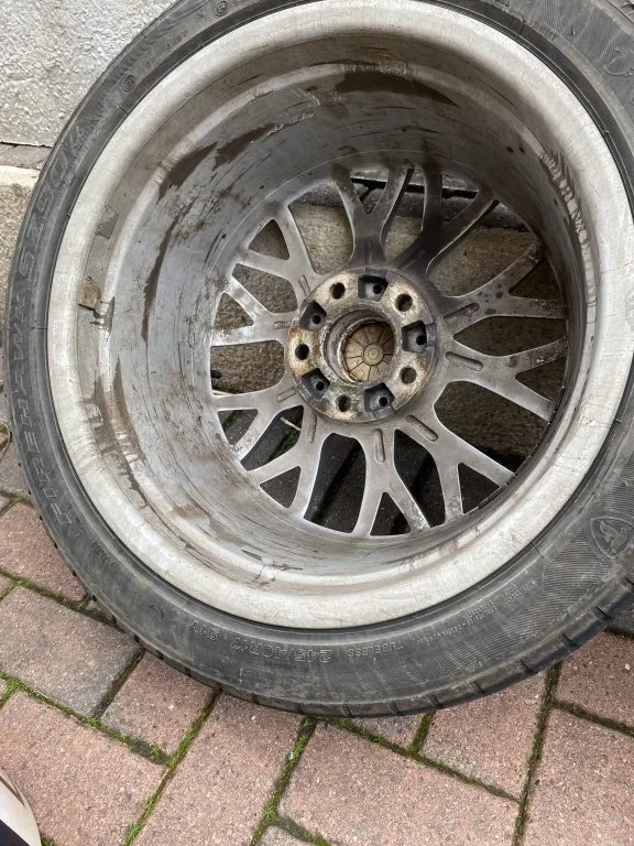

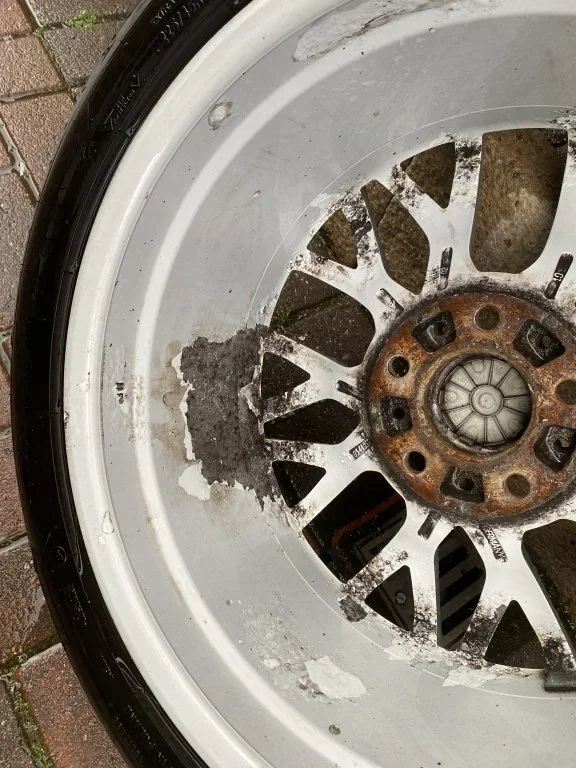

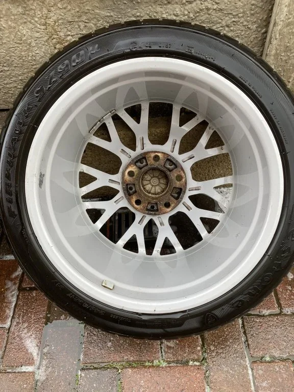

Rims – gave them a deep clean. They are now starting to suffer due to their age with the finish starting to show signs of coming away and the weather getting in, especially on the back of em. In due course I will be having all four refurbished by an outfit in Barnsley.

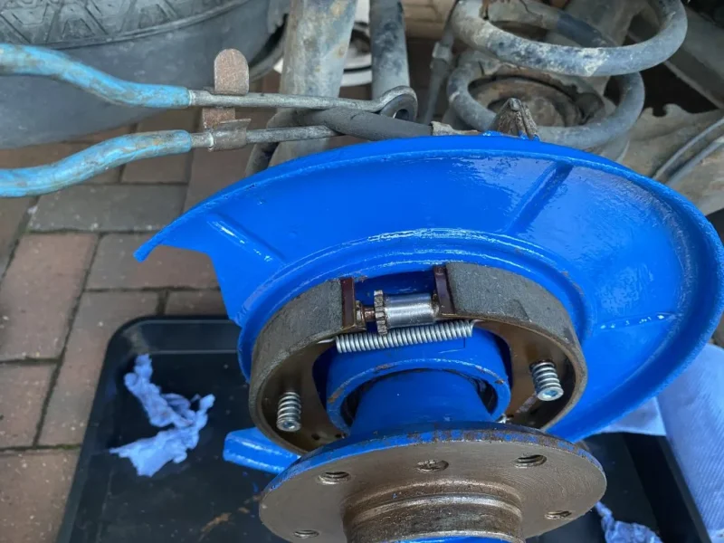

Reset the handbrake shoes / cables, all to the good.

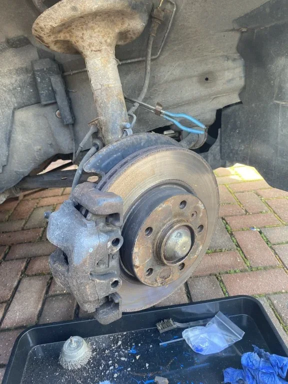

Onto the fronts, trolley jack to the fore, axle stands at the ready
The front brakes would be easier as no handbrake system to contend with, this will be a breeze - Wrong!

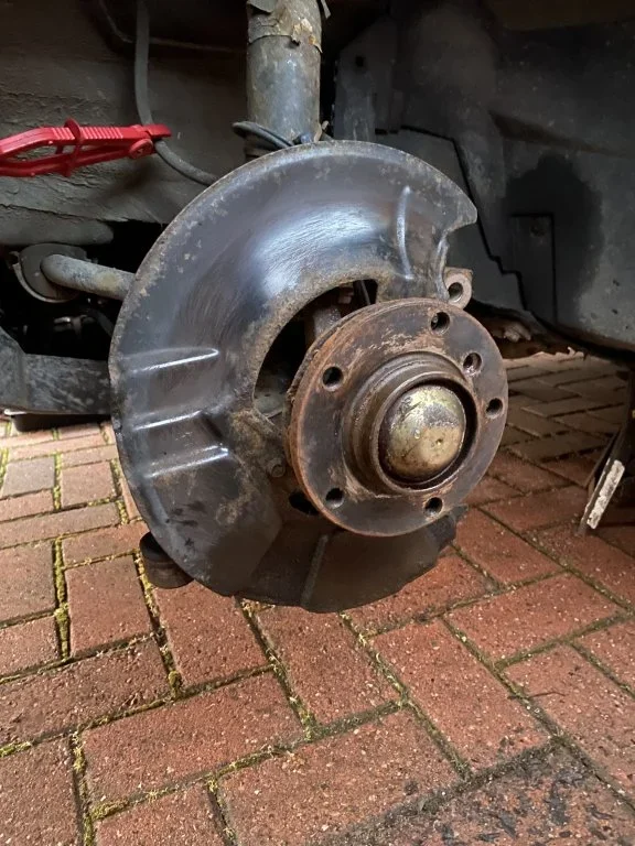

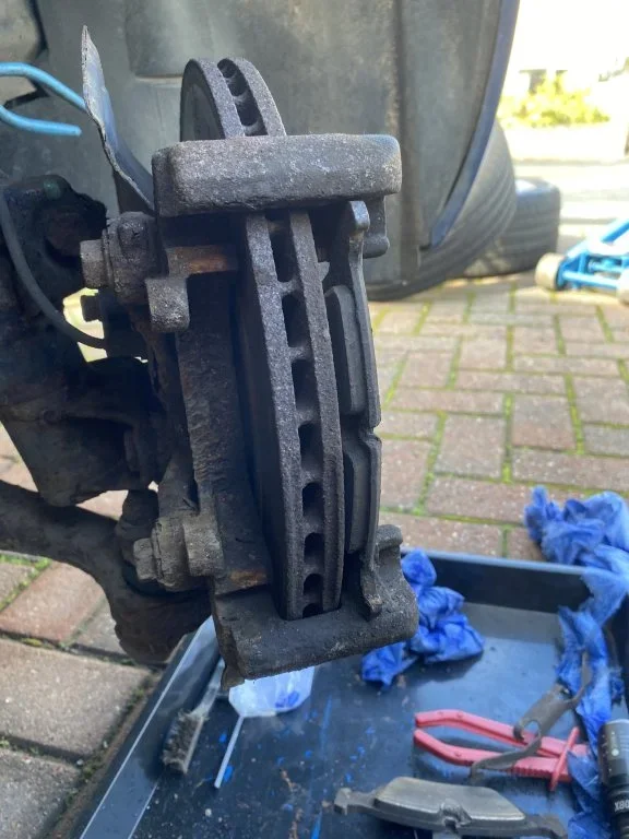

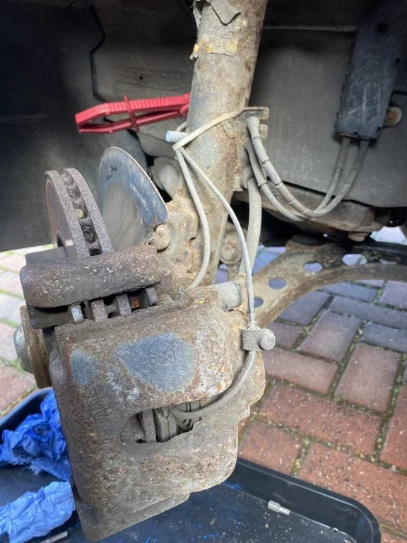

It soon became apparent that previous owners mechanics had been skimping and not employing 'Best Practise' There was not a Skerrit of anti seize grease to be seen anywhere, added to that we are dealing with a twenty one year old classic here

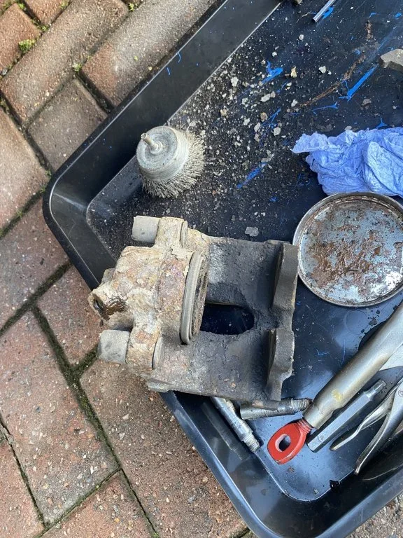

Dismantling was proving a battle, so much so that I had to get the serious half inch drive socket set out along with the longer shifter bar. Getting off the discs was proper challenging, they have a shouldered locating Allen key bolt on each side. The offside required releasing agent and a blow torch before it gave up, Nearside was a tougher 'Nut' to crack, despite using releasing agent and the blow torch ended up having to hammer in a torx bit to get it turning. This has of course knackered the bolt, a new pair of bolts will be sourced this week.

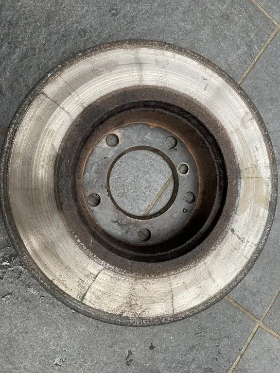

The pads are well down - Need new uns. The discs on t outside seemed acceptable, on the insides they were far from acceptable, again a new pair will be ordered this week. The callipers and carriers were in a right state, took me ages round at my mates using his blast cabinet to get em cleaned ready for painting. Both pistons, seals and dust seals were replaced along with bleed nipples
The front rims - looked fine on t outside, the insides however are a veritable nightmare, with the finish parting company and allowing the weather to pit the surface. All four rims will be refurbished sometime this year

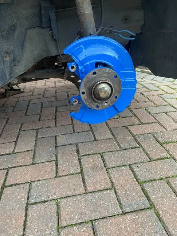

The splash guards etc have cleaned up fine, I have wire brushed, detergent washed and will chemically degrease prior to two coats of paint
Painting the carriers and callipers will commence this afternoon after Clay shooting this forenoon

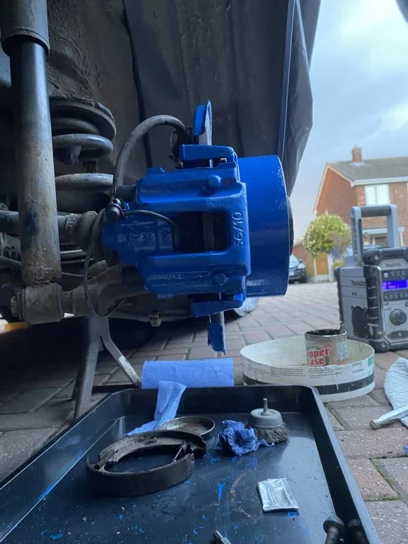

Anyroadup, in t afternoon got both carriers, callipers and splash guards first coated. I'll call in at GSF tomorrow and source / order discs, pads and retaining screws

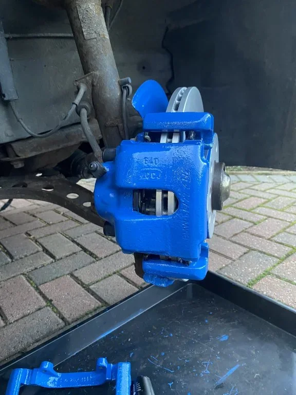

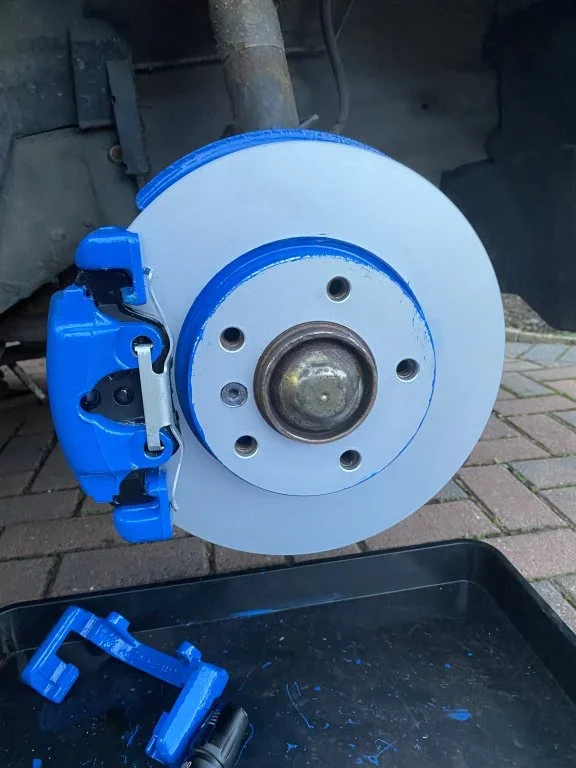

Progress - over the past few evenings and at t weekend I got the front braking components, cleaned, painted and serviceable items renewed - Pistons / seals / dust seals / Guide rubbers / Bleed Nipples
Got in early enough today to get the offside built back up, I'll get onto the nearside tomorrow, daylight and wx permitting. Then of course a test drive will be compulsory to bed the lot in

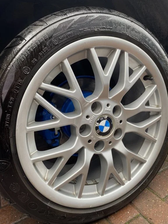

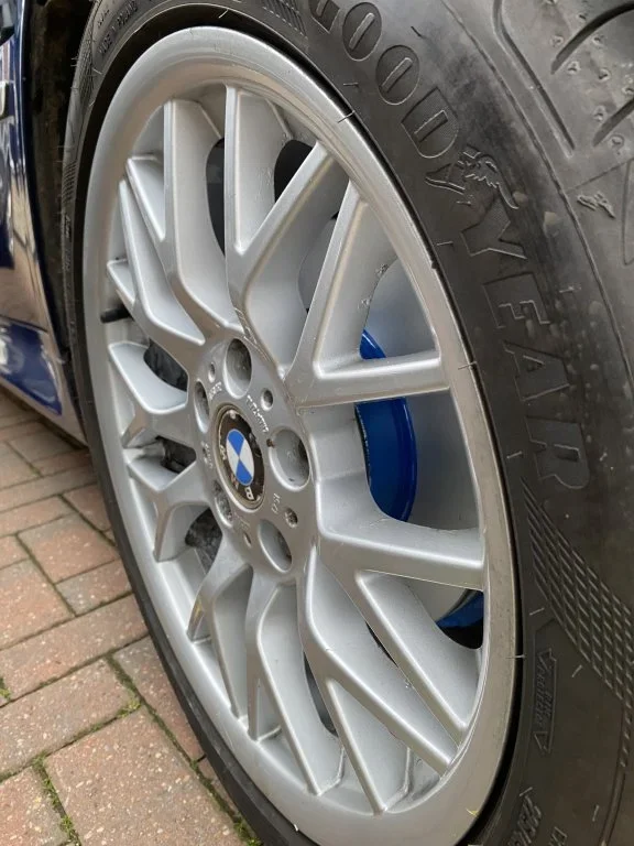

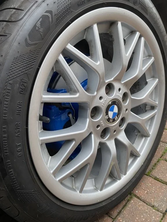

That's the nearside front brake assembly back together. Bled the remaining original old brake fluid out of the system, confident we now have fresh DOT4 throughout. Went for the obligatory test drive and bedded the brakes in. Just love driving Zebedee - Its proper addictive.
The brakes and discs can partially be seen through the wheel spokes - Looks kinda good methinks. Brakes are performing just fine. A bonus was curing a decent 'Heavy' rattle in the cabin, my lad was in the passenger seat, moved the seat back. After he had departed, the rattle had gone - Bargain 👏
