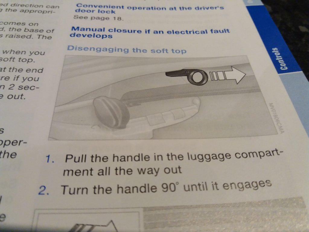

i can get my roof up & down manually the red release ring just flops about as if doing nothing i think ether the brass button it moves on the pump is stuck or ive got a oil leakIf the motor is running then the drive is disconnected by the sounds of it. Have you followed the full process of using the roof manually? I'll check my book later.
By red ring you mean this one?i can get my roof up & down manually the red release ring just flops about as if doing nothing i think ether the brass button it moves on the pump is stuck or ive got a oil leak
yes that"s the one there is no resistance it do not spring back it just feels loose & disconnected i dont know how it should feelBy red ring you mean this one?View attachment 92985

Sorry if you know all this mate, just covering options. You could be right about the disengage cable. Can you push it back in. You have to pull and turn to release it to go back in.

hi thanks for that im beginning to think bypass valve or oil leak when the weather gets better ill try & move it to the boot i think thats best .Hi, if the top has been in "bypass" mode for some time, the brass button on the pump is stuck in. You will have to access the pump to free it up, but easy fix otherwise. You can google "Z4 bypass valve" for more info.
Actually no because on the Mustang replacement pump there is no bypass valve. Very common that your bypass is simply stuck in (as opposed to an oil leak) if your cable has been pulled for any length of time (as was mine).Great info Andrew, just a thought, have you tried to operate the disengagement cable since you moved the motor to the boot?
