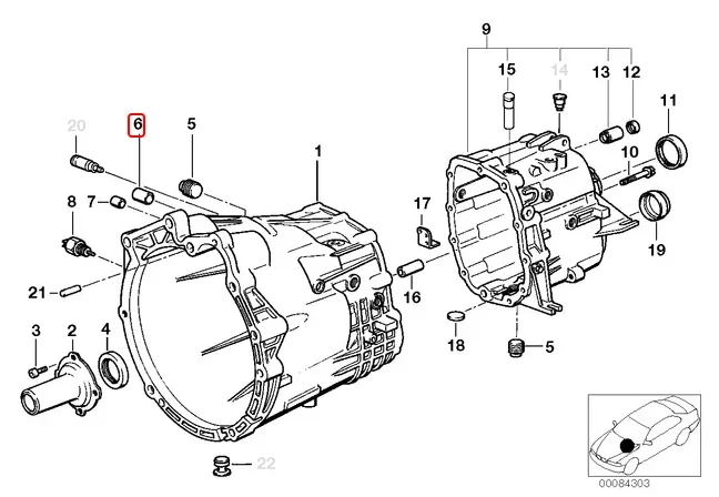

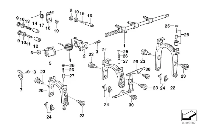

@Lee - could I ask where you got the shifter pins from? BMW dealer? - the 5th gear one seems to fetching a price! Was there some sort of kit you can get all the locking pins/bushings in?
Axle stands!
I take my hat off to you.
What kind of clearance do you have under there? Any photo from a little further away showing you working, preferably lying there with your arms wrapped round the transmission, to give us, or me at least, a feeling for how tight it must be under there. (Before I go out and buy a hat to take off)
Yeah that 5th pin is expensive now. You don’t actually need to change it, it’s the liner that wears away so you could opt for not buying the new 5th pin.
Great idea! Thanks.
FYI these liners ("plain bearing") are no6 and no7 on attached diagram. Anyone know why BMW suggest a quantity of 2 for each?
