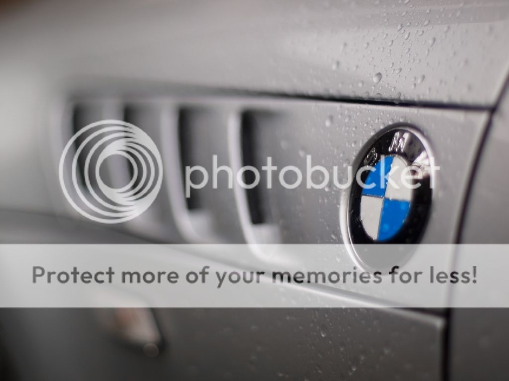

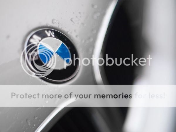

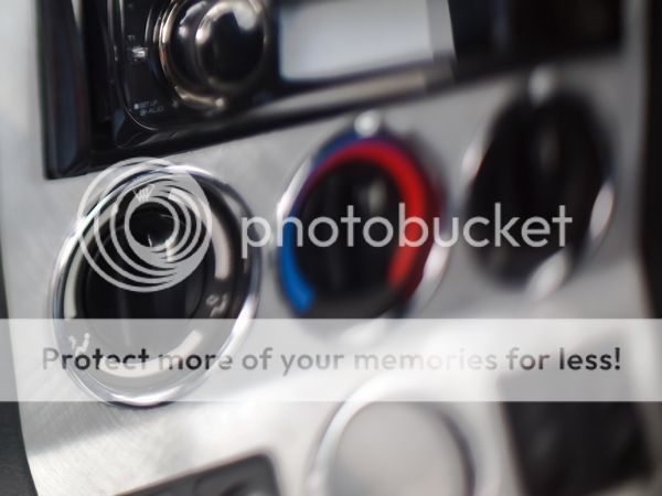

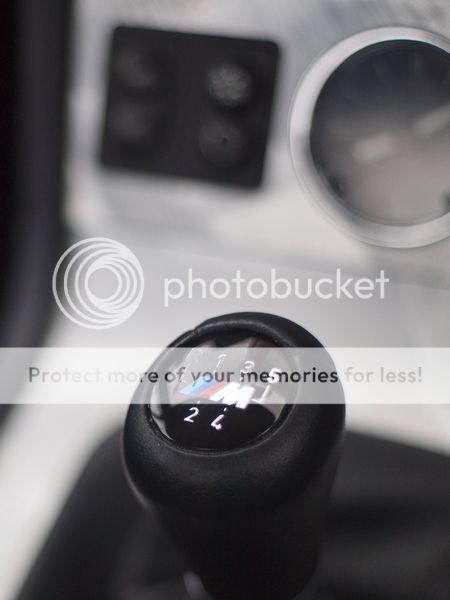

Just taken a few piccies of the zed with my home made Tilt Shift lens adapted from a 50mm Olympus lens off of ebay...what do you guys think?
I'm pretty pleased for a first try! :)

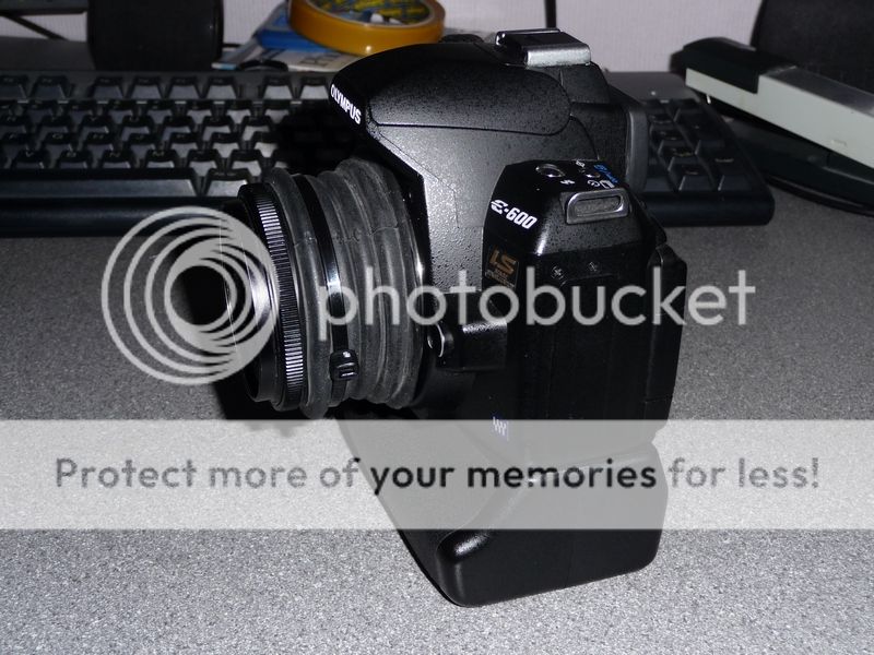

You can do it various ways, the expensive way is to spend ~£1000 on a professional lens, or you can do it the cheapskate way and adapt an old lens something like below:
The idea is that the lens isn't fixed rigidly to the camera body, you can tilt & shift it around to get different focus effects. I already had a duff lens and other parts available so thought I'd have some fun with them!
BTW, the bellow section between the camera body and the lens comes from a Z3, it was previously used to protect the antenna base in my car!

Love the effect. I'm keen to learn more. I've got a Minolta 50mm 1.7 but I doubt I'll get anywhere near that narrow with it. How have you actually attached it to the camera? And how do you take the exposure? Excuse me being a bit thick. I can't really make it out on your image. If you're going to ZFest will it be making an appearance? You could have a nice little earner going round taking moody shots of cars and flogging them for a tenner a go!

Hi Olly, try this website probably the best one I've seen so far, should be enough to get the creative juices flowing!
http://cow.mooh.org/projects/tiltshift/
I'll post up some piccies of my set up when I've got some time. Off to London the weekend so going to try and get some pictures from high vantage points, if I can keep out of the pubs that is! :p :beer
