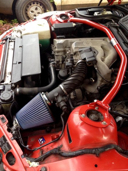

That's an ACS strut brace. I have fitted one of those, no clearance problems at all!It does appear to sit quite high the E36 is alot squarer than the zed. Is it not the strut towers that are high is it mine sits mm off the engine and alot lower at the turrets.The bar angled more in keeping with the zeds bonnet.
Frustrating when it clearly states it will fit !!
The Z3 is one of the most flexible roadsters out there - i think putting your seat belt on helps stiffen it!I've got one fitted and it did feel like the front end was tighter and more precise after fitting. But how you "measure" that is another thing! It could be the placebo effect! Either way it will stay.

I have the same one on mine as Ant's but it definitely not an AC Schnitzer one. It pretty much touches the DISA valve, had to make a slight modification to it to get it to clear.That's an ACS strut brace. I have fitted one of those, no clearance problems at all!
Bonzo.
Sorry, I should have said it's an ASC strut brace, not an ACS....I have the same one on mine as Ant's but it definitely not an AC Schnitzer one. It pretty much touches the DISA valve, had to make a slight modification to it to get it to clear.
I think it's shaped like that to fit the 1.9 litre engine! I would think not as torsionally rigid as a straight one, what with all those bolted connections.View attachment 75783 Here's a pic of the Chromiumtec front strut brace I bought for my Z3 2.8L after considering the risk of damage to both sides. It looks a bit like it was made to negate some of the collision stress to the opposite side by going towards the bulkhead (also giving it more room as the bonnet rises towards the windscreen)before going straight across a bit like the ones fitted to the Z4 (plus it's got a cutout on the cross bar), hoping it just might break where it joins the bar going across. That's the reason I bought this one. Fingers crossed as it's not an exact science. The differance in handling wasn't noticed as I fitted Poli bushes at the same time. Paid £120+ for it though so reackon this type are overpriced and maybe still allow just a morsel more flex than the ones going straight over. Had to make up a bracket for the underbonnet multi diagnostic plug to allow me to use it without removing the strut bar( easy enough). Also bought Bertini rear top and bottom strong strut.
