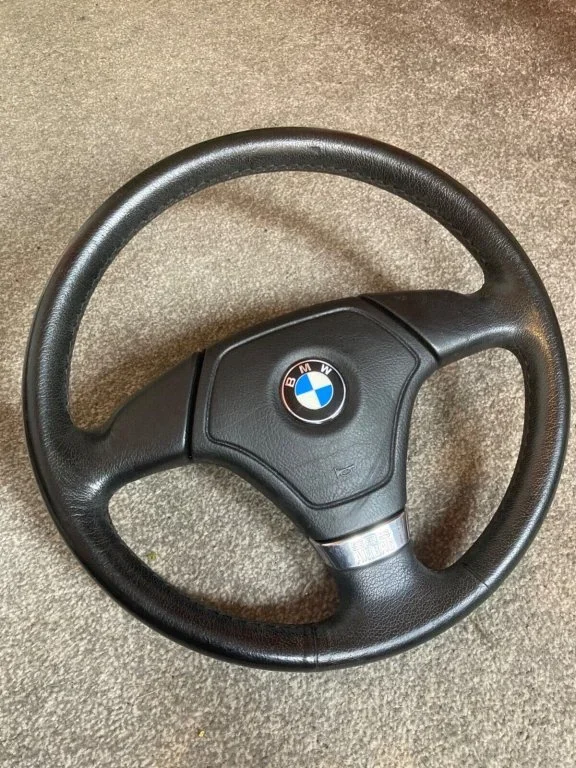

I'm looking for a Z3 wheel if anyone has one in the garage going spare?
non multifuntion
airbag- yes
3 spoke
Drop me a line if you have one
Thanks

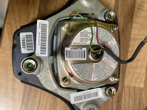

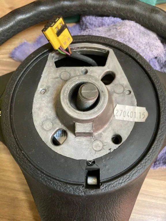

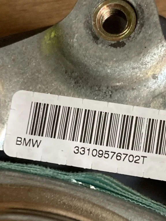

£50 posted. Let me check all the part numbers etc and I’ll post up a pic of the slip ring.
Andyboy
Jun 2, 2019
119
SHEFFIELD

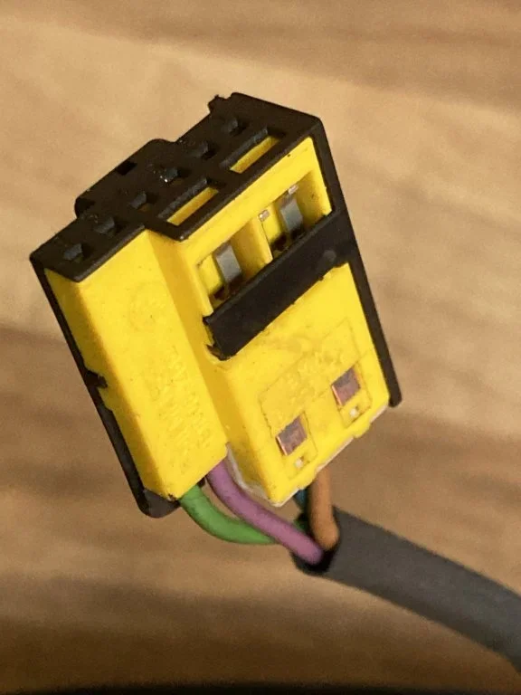

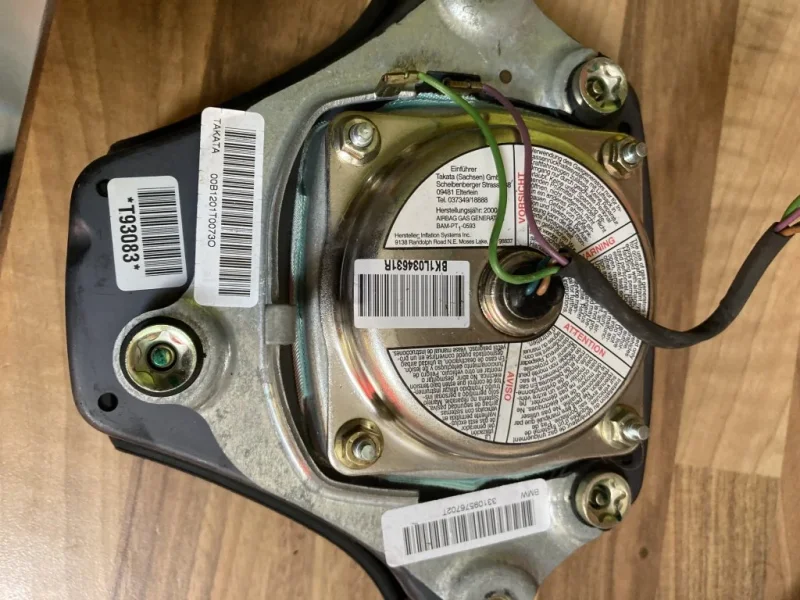

I can't make head nor tail of the airbag part number.
I've had it 3 years or so - I think it came from a W plate 1.8. It has the E46 type airbag connector.

Just for information relating to this thread
Pre face-lift zeds have single stage airbags
Face-lift zeds have multi stage airbags
Connections are different and are not interchangeable.

Thats looks like a pre-facelift wheel to me.. didn't they only have a single stage airbag ?
That's interesting! TIL that even the airbags are different on facelift cars… ;)
On a bit of a tangent, why is the M Sports Steering Wheel listed as multifunction? I would expect a multifunction steering wheel to have some buttons (radio, volume, whatever), which mine certainly doesn't.

@Bigwinn I would suggest you will need to look for an e46 3 series car with the triangle steering wheel from a certain era that has the old style steering wheel but a dual stage airbag. I would expect that the majority for sale will be single stage airbags which wont work with post 1999 Z3s. Thats not to say that they don't exist as dual stage bags but a little research and cross referencing of part numbers will be important to find the right combo.
The steering wheel itself is fine, just the airbag is the issues.
