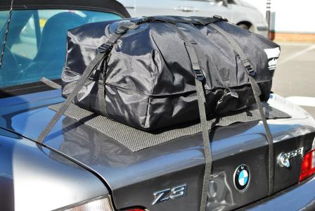

A good thing to keep in the car, albeit very expensive for what is it (really...a kitchen top mat and two belts) can be this:
So you can put your flat tyre on the boot without making a mess inside the cabin or leaving it....
