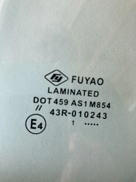

Just got the front windscreen cracked.
My Insurance Company wouldn’t cough up for a genuine BMW Original windscreen so I had to accept a copy. Previously I have heard that Pilkington windscreens do not fit properly as they don’t have the correct curvature at the top corners.
I was pleasantly surprised when Auto Windscreens of Southampton fitted a FUYAO Windscreen with a new sealing rubber and it fitted PERFECTLY.
