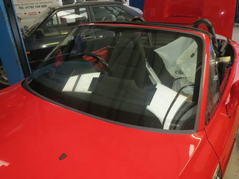

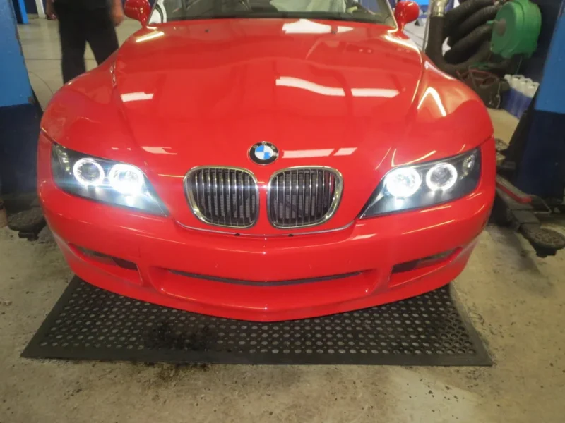

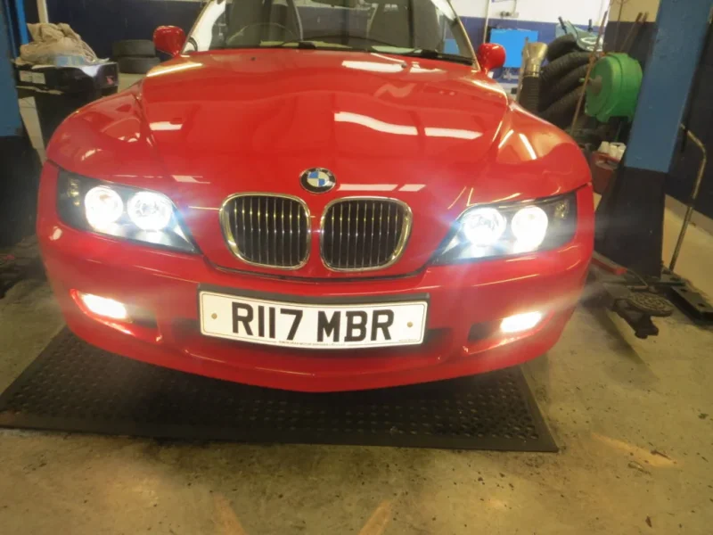

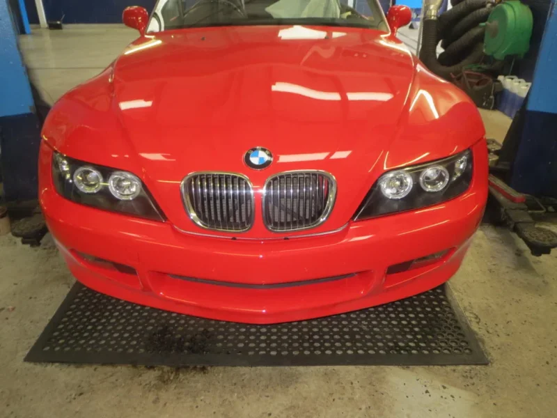

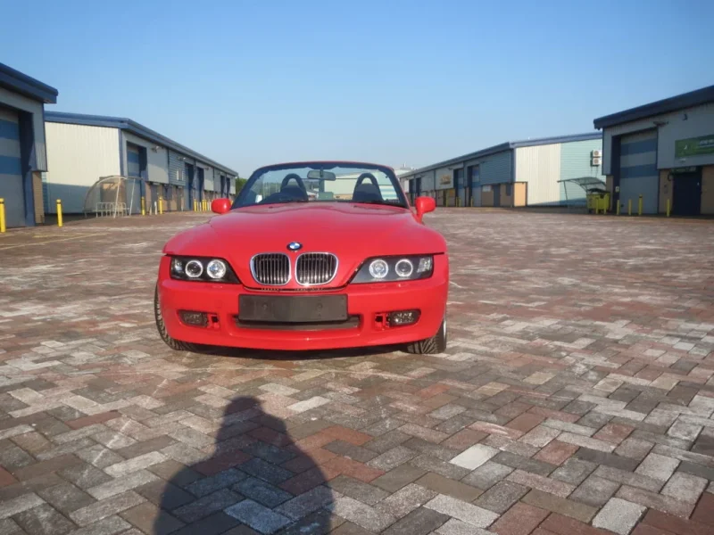

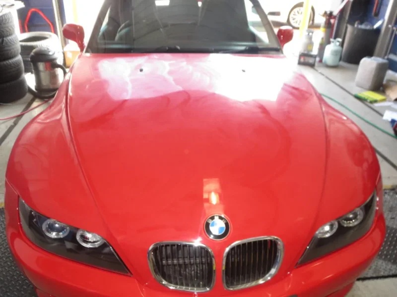

Front end with new halo headlights installed.
Wired them up this afternoon...

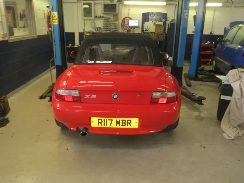

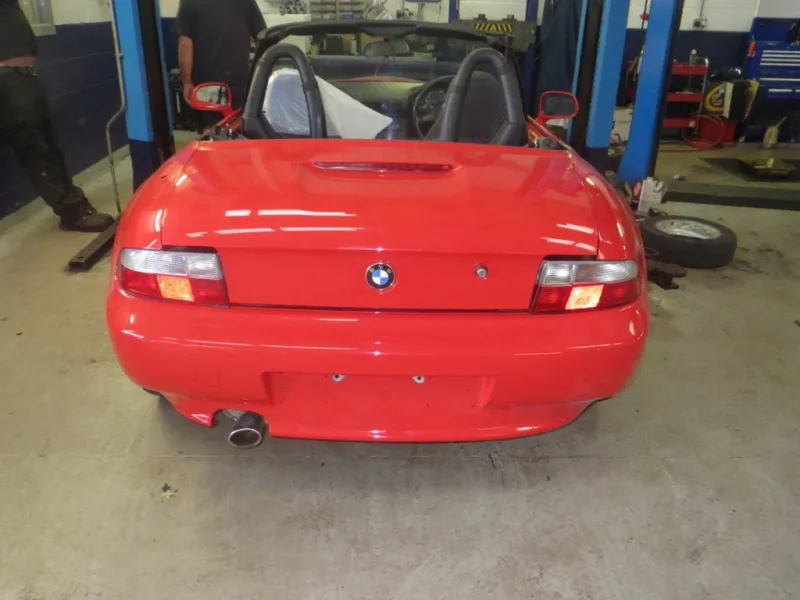

Rear end some new clear lense lights to tidy it up...

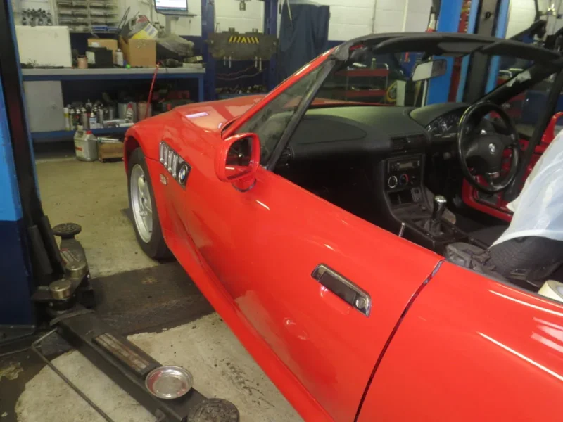

Got the nsf door handle in with the chrome from bmw.
Tomoz doors and window glass :)

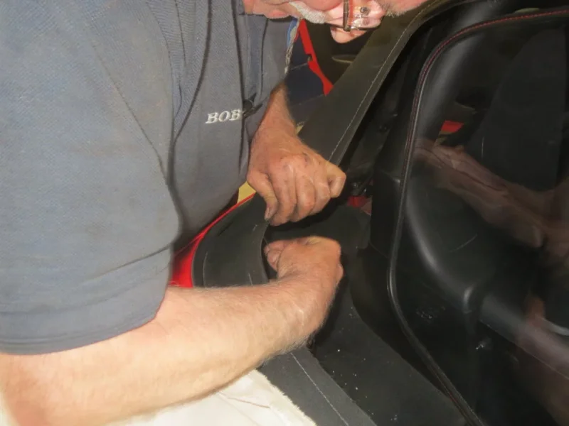

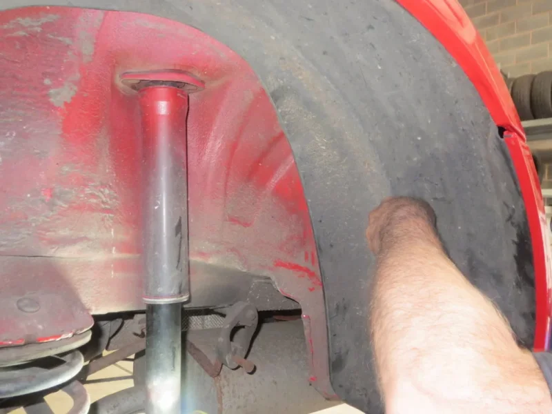

Today we put all the arch liners back and rebuilt interior door panels and locks.IMG_1441.webp

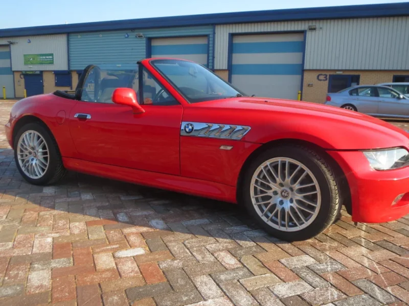

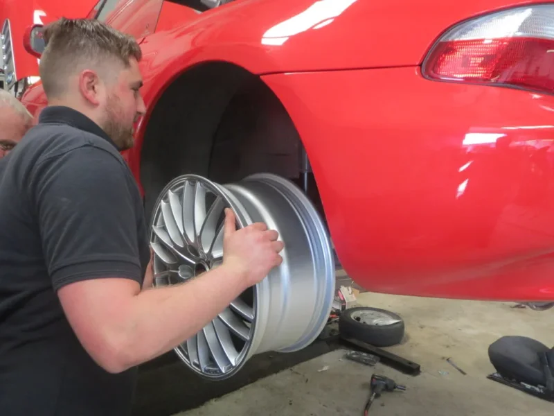

The rims have arrived so just checking they fit before we put the tyres on..

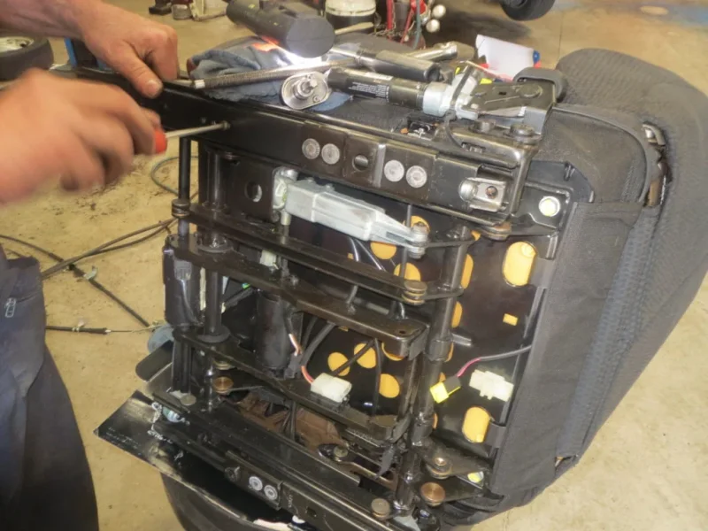

Started to remove the seats to do the seat bushes which I got from the forum :)

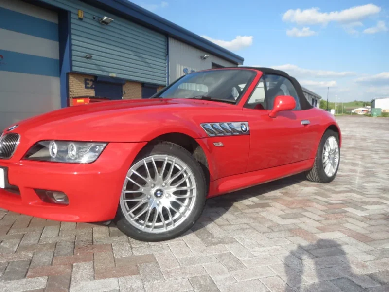

Still requires final clean and polish but here are a few pics of how she looks at the mo..
Front end coming on :)

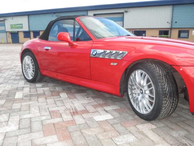

17 inch Borbet cw4 wheels with Uniroyal rain experts on.
Lots of debate on tyres I have read but these are well under rated and brilliant in the wet
and at 43 +vat each bargain !

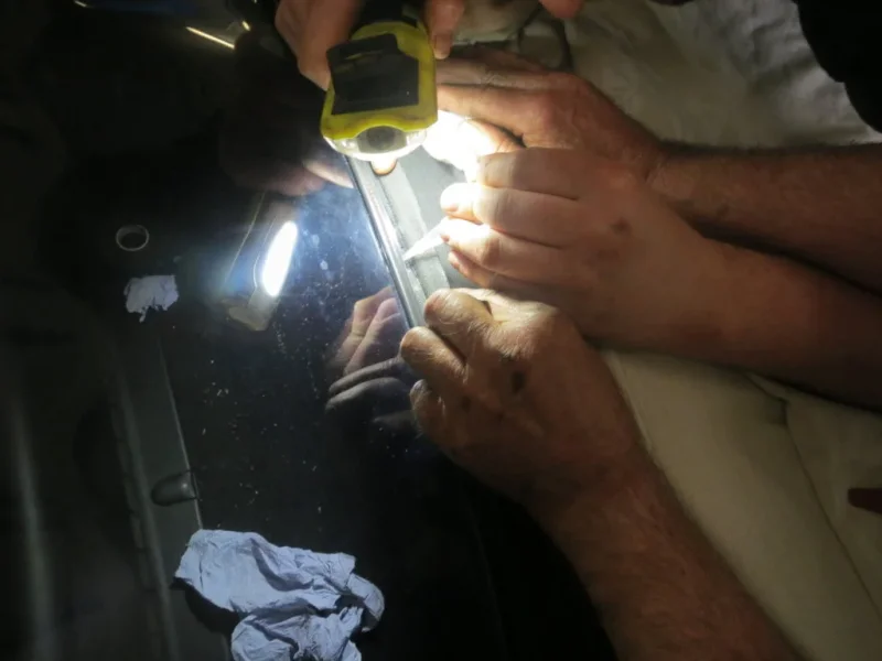

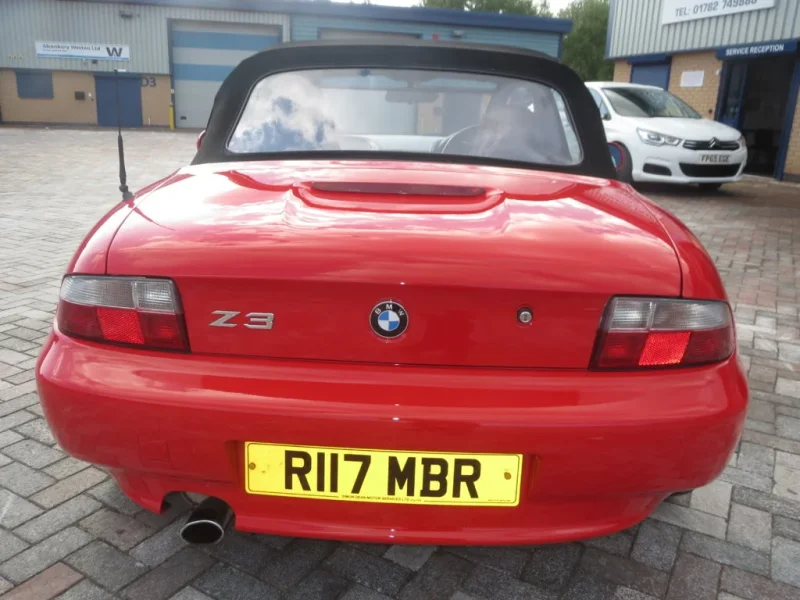

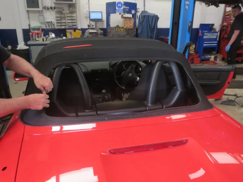

Got the screen out as badly scratched.

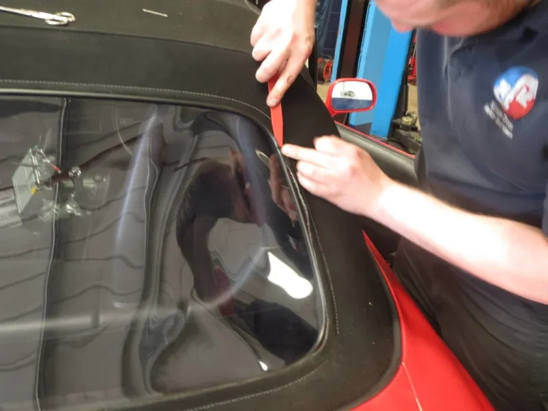

But its been a nightmare as the start of the zip on the roof is in poor condition.
Also the bottom corners of the roof trim have ripped slightly and we couldn't zip the zip !
So bit of sewing went on lol.
got the screen to eventually zip in but got to repair the bottom corners then add a grey stitch
where its missing and then finish the outer trim n hopefully it will look ok.
Also got the badges and plates on and fitted some night breaker white light bulbs.
Trying to finish rear screen is next job.....

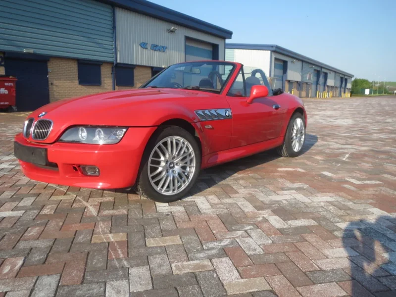

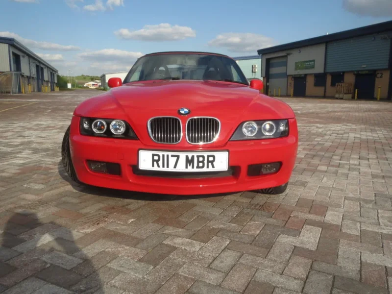

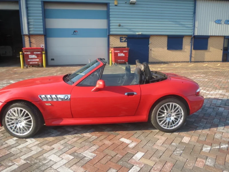

I spent all day today finishing off and cleaning so below are the finished Pics.
Out tomorrow for a spin :thumbsup:
Finished the rear screen today a bit more sewing and fettling..
Wax on Wax off....
Finally finished with a restore time of around 200 hours approx. on and off !
Thanks for looking :thumbsup:

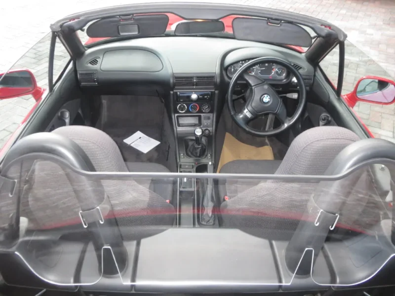

Interior is a little tired particularly the seats so just interior to do !
