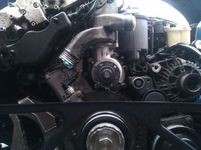

A lovely job - NOT.
Althulas
Jun 14, 2014
198
Banburyshire
M Roadster
Cheers Pingu, a pain in the ass job to do but was worth while for me changing the water pump, belts, worn pulley wheels, clean up the tensioners, clean the rad and flush it. While that lot is out the way a good time to change vanos seals, bolts and gaskets if required while the space is there so one silver lining.
Pingu
3rd Party Trader
Dec 8, 2011
145
@Althulas - that's the thing. It's not a nice job if it's just the thermostat that needs doing. I agree with you - if any of the other stuff is suspect, it's best to do it at the same time.
Access with radiator removed...
