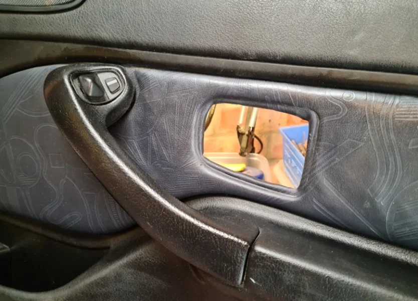

Herewith the old and the new. Please admire the unicorn skin and precious materials used in its manufacture to justify the price. ;)
As suggested above, if someone could make replacement "plastic bits" to fit in the ends, they would be on to a good thing.:thumbsup:

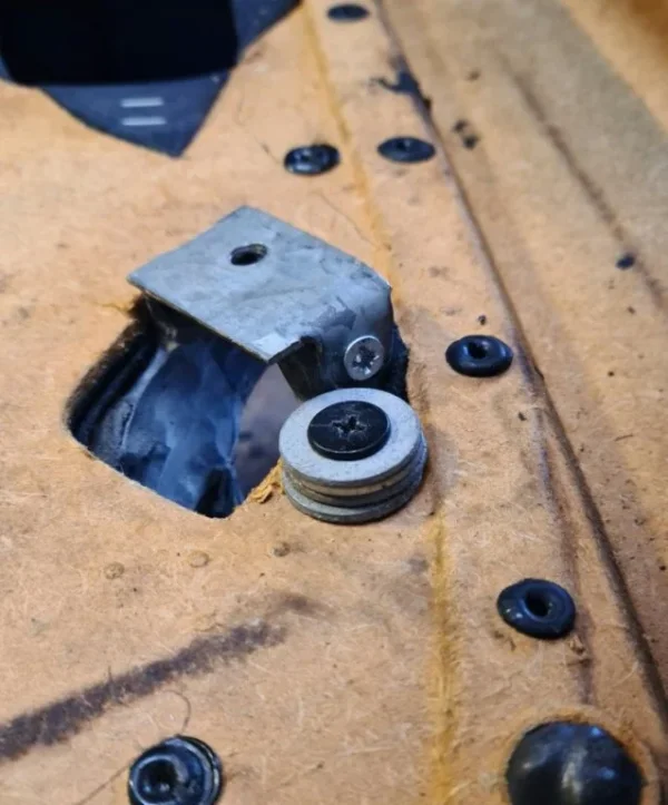

I've just bodged my passenger door handle. If it goes again might try to put a metal plate in the back of the door card. Hollow out the handle ends and fill with some sort of resin. Then screw in from the back of the door card.
