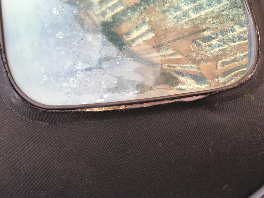

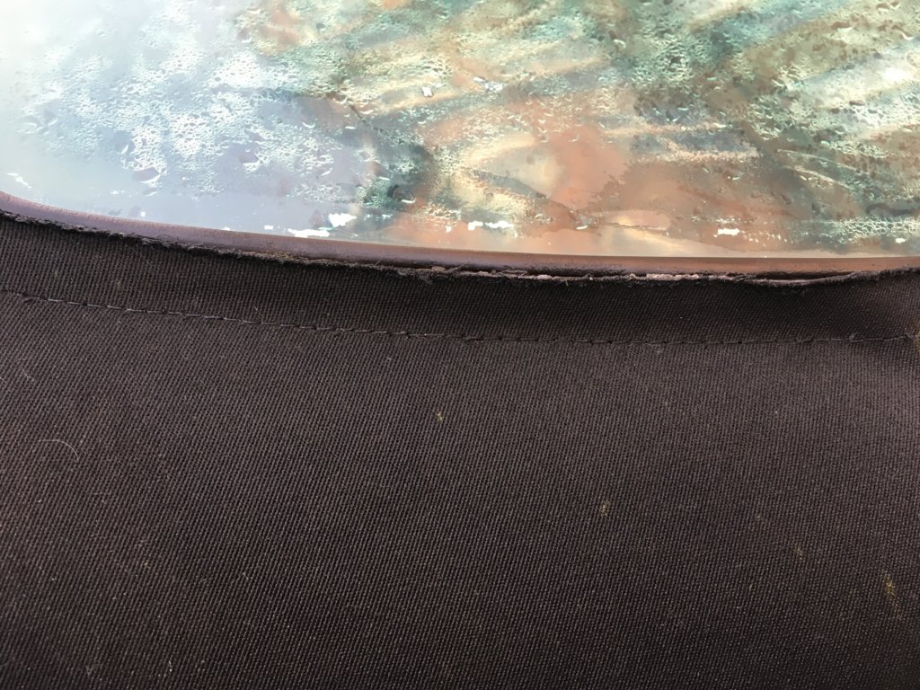

After a break in the weather at the weekend, i gathered my thread and needle and set upon the hood. After 5 cups of windchilled coffee i ended up with not a bad result at all. I'll get pictures up shortly to show you the work but its really about the process. It'll be a picture of some stiching on a hood...
As @Stevo7682 advised, i used a wedge between the hood and windscreen to effect some slack in the window panel of the hood to allow me to sew in the Nylon thread. The rotten stiching on the side was about 15cm long and i used some pinning needles placed 4cm apart to offer up the hood to the window's zip fabric. Using a back stich method to try and match the style on the hood i managed to do a decent enough job and allign everything sufficently to allow for a window replacement, which is the main aim.
It really was a fiddly job but with patience, its more than doable for those needing to carry out the same work. If you have luck like myself, all the pilot holes were still intact on the hood allowing me to concentrate on passing the thread through. If you have a mechanics accommplace with you id have a man in back helping to look after the whereabouts of the thread in the car. Got caught on the seatbelt several times and little pillers in the car.
Even with the simple sew, the cars less misty inside and hopfeully less damp. Stage 2 is the window. Stage 3 is clean & re-dye. And dare i say it...the hood might be done. :cool:
£3.76 well spent for the time being.

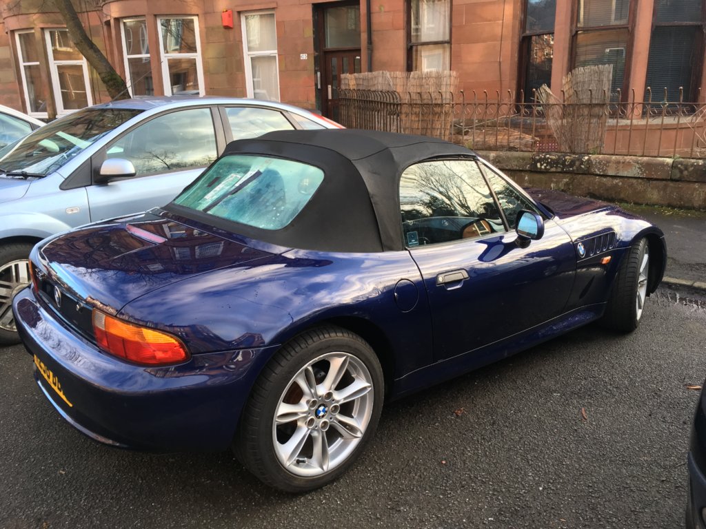

Gave the Z her first wash this afternoon. Pretty pleased with the depth of the paint colour. Montreal Blue sure is a pretty colour to look at. To think i couldn't be swayed from only looking for one in Black. For a 20 year old car, shes in pleasing condition. Documentation with the car indicates it's lived 80k miles of its life on the south coast of England. I think its helped keep it as well as could be hoped. So thank you to Mr Taylor in Southhampton. Pics are from before use of a clay bar and 'superresin polish' off the shelf from authoglym. Not enough light left to take a picture unfortuntately. Thoughts on the Z4 wheels that came with the car?
Had a feel under the carpets too and as @Stevo7682 suggested, the foam underneath is pretty wet. Wet through I'd say. I wasn't sure as i couldn't quite peak in, but i think I felt a finger tip of pooled water possibly at the bottom too. Would this be possible or am just feeling run off from the foam it's self? Irrespective off that, the carpets have got to come out I think. Scottish weather and a leaky roof. I need to do the bushing repair on the drivers side so I think this has moved up a notch on the priority list.
