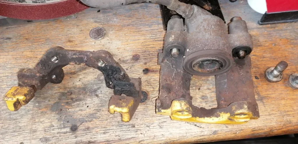

today I cleaned up and painted the diff removed the rear bush and replaced it with a poly bush so it went from this
to this
also stripped media blasted and painted the rear calipers
the rear flexible hoses arrived today so just waiting for the new pistons and seals
