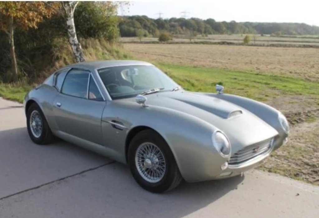

Not the best job from the photos. Interior looks decidedly 'bodged' IMO. Uses the Z3 gear knob and some switchgear.
MOT history check is not good; it looks like it was an import in around 2019, as the (limited) history is in Km.
Still registered as a Z3 so God knows how they got an MOT. Oh hang on...it doesn't have one and hasn't for 18 months!
Obviously 'finished' in 2021 then took for an MOT where it failed on multiple issues of not being finished properly.
Around £15k auction price for that IMO (and that's a huge risk for the buyer). If that's the case, then someone is losing an awful lot of money.
MOT history check is not good; it looks like it was an import, as the (limited) history is in Km. Around 80k miles.
Still registered as a Z3 so God knows how they got an MOT. Oh hang on...it doesn't have one and hasn't for two years!
I'm sure there is a tale to tell on this one. I like the interior personally. It is quite unusual for tributes to have a different set up inside. Always compromises to be had with Z3 electrical snafus and ease of change.
Agreed on the risk though. Looks like it has been in storage for some time probably explaining lack of MOT. Should have had re-reg done too.
I agree. The tale (from the limited info) looks like a conversion done on the cheap and for some reason hasn't been on the road for a good while. Which rings alarm bells for me.
Chances are the Z3 was a South African import which are dirt cheap as there is no history when imported.
Without a current MOT a car should be sold as 'spares or repair' IMO as it is not roadworthy.
These auction sites really should not be allowed to bullshit like they do IMO. It is mis-representation.
There was a Z3 rebody sold at auction late last year which, in the blurb, said it had original Borrani wheels. It didn't. It had the same Chinese replica wheels as everybody else's just with £5 eBay stickers on. They also stated it has an Ansa exhaust system. It didn't. It had an exhaust from John Smith down the road with some Ansa eBay stickers. It also said it had bespoke wool carpets. It didn't. It had Woolies carpets which were definitely not wool.
We all know these rebodies are fake, so why try and pull the wool over buyers eyes? It is not on IMHO.
