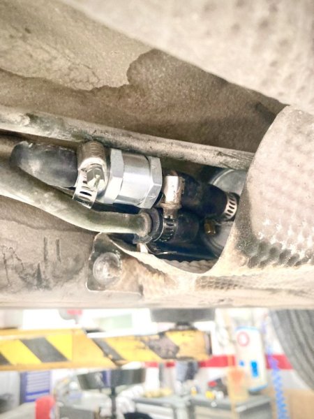

Recently I sensed there is a tough start. To overcome the problem I’ve been waiting to turn over 3 seconds after the dash lights disappear. Seems to have worked - but once in a while it really struggles to start (need to wait a few minutes).
Not 100% sure what’s going on - but I sense it’s a failed one-way valve in the fuel pump. I guess I can verify by checking with a pressure gauge.
As I’m really fed up going into the fuel pump - I’m going to try a more superficial option. Today’s plan is to insert a small one way valve inline with the fuel filter (6mm). Any thoughts?
I’ll update.
I’ll update.
