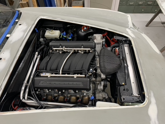

Hey Pingu, hate to p*ss on your parade but can your power plant compete with this?
Corvette 6.2 (or 6.7) with Corvette gearbox and diff fitted to a Z3 with 250 body. The guy who is doing this is seriously talented.
No. That is what Deano has (engine wise - LS3). It's better than any Z3 engine - more power, better economy, cheaper fuel. The corner weights and chassis design are probably compromised, but that's the price you pay for going "off-piste". BMW designed their cars before building them, kits car tend to be built and then you live with what you get. I expect the LS3 250 will be an absolute hoot to drive - like Deano's, it will probably be over-powered and a nightmare in the wet, but it will be fun finding out.
