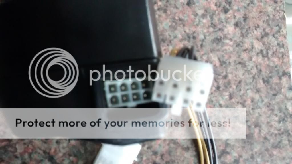

just an update for the alarm fault i had.
symptoms were...
got fob working
doors locked and unlocked
indicators flashed with lock and unlock
top hat led flashed as it should.
the siren didn't chirp on lock and unlock or sound when being set off.
after removing glove box and checking every wire for feeds, earths and door boot radio switch bonnet triggers
everything checked out ok, so you think suspect siren....no... after tracing the trigger feed to the siren from
the alarm ecu when alarm activating it was there at ecu but it was not at siren.
found the molex 8 pin plug at the siren had a corroded pin in the plug not making a contact.
the interesting bit is the plug for the siren is an 8 pin atx computer molex plug.
just picked one up and am going to solder it in place.
http://www.ebay.co.uk/itm/4-Pin-Mol...n_Power_Cables_Connectors&hash=item4d1f8f4dfe
will keep you all posted.....

Billyuk1966
Aug 17, 2014
39
manchester
hi,
just a quick update "alarm working"
soldered the new siren connector on and insulated the wire plugged in and bingo!!!
it was hard to see with the siren plug on the car but you can see 2 pins are corroded inside the plug.
any body with no sound from siren always check the connector plug for corrosion....
tried to take a picture of the socket for future reference but crappy phone camera...
cheers everybody for the help.
love the beeps when it arms and disarms....
