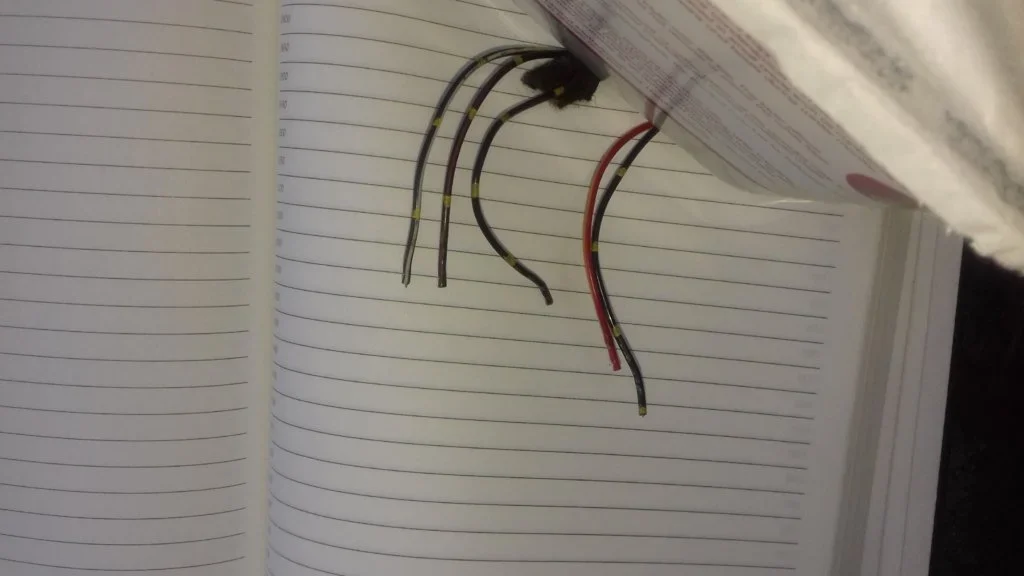

Hi Tony
My alarm issue is it goes off when I unlock the doors with the remote. Is this the same as yours?
I have traced to tilt sensor so far as it was water damaged.
As I have a 2002 Z3 2.2 I would assume our wiring loom shoul be the same colours connected to the tilt sensor
Can you confirm the wiring colours on your connector as all but 1 of mine were corroded off. And fell off when I touched them. Have you got a photo?
My number 1 was still connected. Black and white.
Then I have 3 red and black wires and 1 orange and yellow wire.
My number 6 pin is blank on the connector.
There are lots of tilt sensors on eBay but none have the correct numbers
So I assume they are not the correct ones

Hi Tony
Norm
This is a pic of my wires to the sensor
Will be in touch when sensor arrives
Cheers Tony
