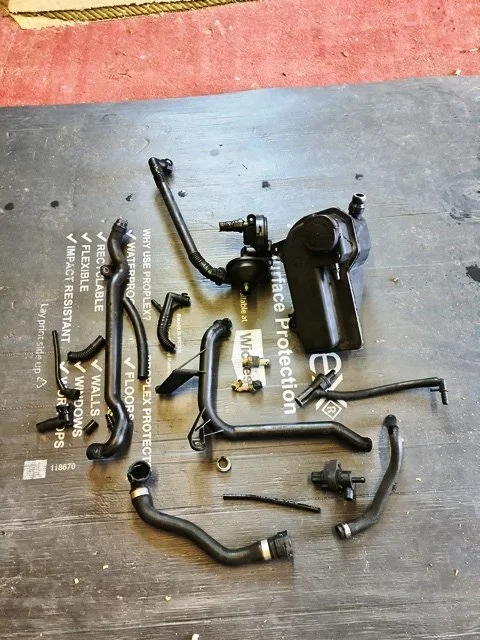

A short day yesterday at work so thought as I now had all the parts I'd rebuild the manifold. Got everything bolted on and then noticed the new crankcase vent hose had unclipped so left it for last night to start afresh from work today. Realised I had to take the whole lot back off to gain access. Did that bolted everything down stuck all the air intake back on all I needed to do was connect the F type fitting into the air intake pipe and SNAP! The engine block breather pipe (sucking jet pump) decided to snap leaving the whole lot to be dismantled again. At that point every tool was dropped bonnet shut and decided that rather than hit it with a massive sledge hammer I would come indoors. I think that is it now have no interest in spending anymore and will be cutting my losses and breaking it for parts in a few months. Wish I had listened to the missus and that is a first! :bashhead: 😂
Sometimes you just have to do that and take a breather, prefer a single malt though, your nearly there, just hopefully one more push and it’ll be done.
I had to do that the other day on the wife’s copper S, changing the vanos solenoids. Some muppet had been there before and chewed up the torx bolt on the rear one with very tight access but Irvine socket to the rescue the following day when I had sat down and calmly thought through it.
I wouldn't mind I came in to build my brand new bike and both the wheels are buckled! I just looked at the missus and she just laughed and said I think the punchbag is calling your name! The Z3 just taunts me just when I think "ah almost finished she goes like hell have you , have some of that!"
Can I really face taking that bloody manifold off for the 3rd time? I suppose it will be quicker now I'll be dreaming about it in my sleep =))
Well I bit the bullet ordered a new air breather pipe ripped the manifold off and fitted the new pipe and bolted everything back up within 2.5hrs (I think I could do it asleep now)
Codes all gone, tick over is great and doesn't hunt anymore.
Took her out for a drive and now noticed the gear changes up are fine and smooth as they always were but on the way down it feels like it is "thumping" no noises just changing down harder then it ever did before. No codes and not sure if its just because it has sat there for a while but as nothing has been touched but first time I have noticed it but it was nice to finally hear the engine running how it should with no coughing spluttering and farting like an asthmatic that's has run a marathon!

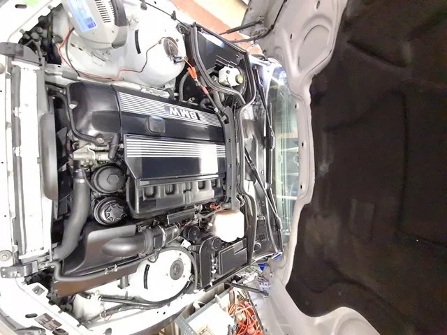

All fluids topped up today ready for the second attempt at the body shop to paint it again and to remove the paint from the tyres and the roof! Oddily satisfying cleaning the engine a little and seeing it complete!

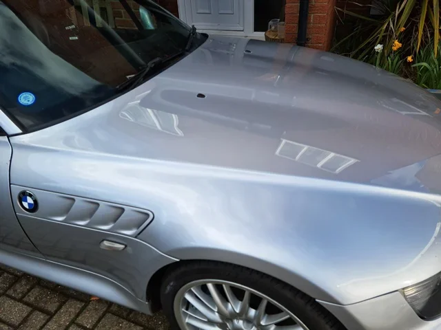

Another update full of woe. The body shop after having her 7 weeks did nothing to her apart from cover it even more in over spray from other cars they were spraying. And now it looks like they have shut up shop after telling me to collect the car in a text message late friday night. The headlights I polished and lacquered are opaque and the idiots even left a roll of tape and a blade on the car so when they removed it I have a nice ring and blade print on the bonnet where it hasn't had over spray. She does look in a sorry old state with white stains on the roof, over spray on the tyres and the whole car feels like sandpaper and is now matt
On the upside the engine that has had all the work done ran like a dream and we actually for the first time owning it got the roof down and drove 70miles for leisure. Even though she looks rough the drive was enough to put a smile on my face and at least the engine work has been worth it. But seeing her doing 19mpg was a bit scary haha but it was an "enthusiastic" drive

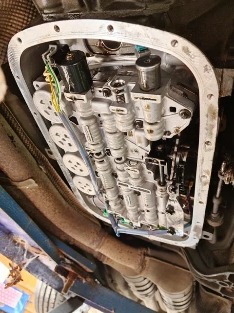

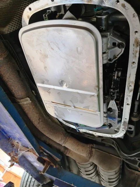

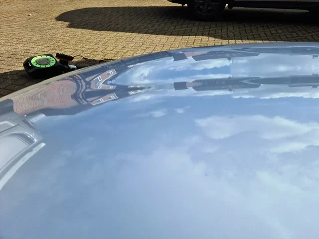

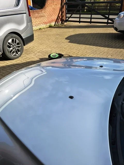

With a couple of body shops declining to even attempt the car and a detailing shop said it would cost too much I ordered a couple of clay bars and set to work on the car. 10hrs later the paint is smooth and had to clay bar it for 3hours then machine cut with 3000, 5000, 9000, 12000 then a polish and sealer. It highlights the poor spray job even more but it is better than it was. Managed to get the headlights back to how they were and cleaned all the interior. As for the spray job think it will be another attempt next year with a different shop or if some good panels come up 2nd hand I'll grab them. She is nearly there just an auto box and differential oil change and hopefully can get her out in the sun.

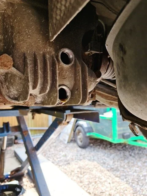

A nice sunny day could only mean one thing and that was to get under the car and do the diff fluid and gearbox fluid and refit the backbox from the mods I had done inside. Sounds just how I wanted gentle burble when cruising but a nice throaty sound when you open it up. All done I thought until I get her back and noticed coolant dripping from the front. I thought I had finally put my last days work in but she had other plans. Was going to take it to drive to a car show tomorrow but guess it will be the Z4. I'm thinking its the water pump from the location of the leak as dripping down and onto the back belt but if anyone has any ideas as to whether they have ever had this leak and where it could be would be appreciated!
Gear changes are a lot smoother now was very surprised at the difference and imagine it has never been done. Thanks to T-Tony for the guide it was a little different for the 3.0 but covered most of what you need to know
