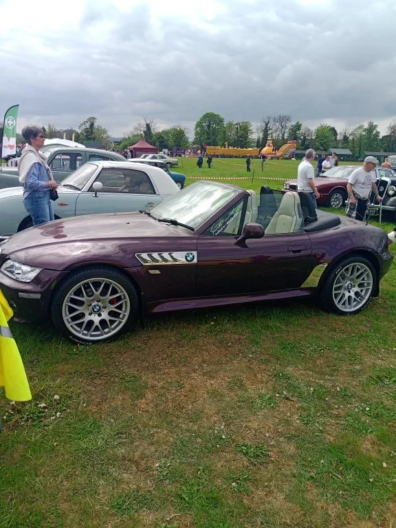

Hi all,
Joined the forum tonight. As the title describes.. I have a 2001, 2.2L widebody Z3 which I am in the progress of restoring.
Hopefully, if all goes to plan, it will be my lifelong buddy and share a journey with me.
I make no apologies.. I'm not a purist, this is my car, I want the look and feel in the cockpit that I want, which may differ from BMWs initial ideas (I despise orange LEDs despite having had many other BMWs which still have an orange dash 🤣🤣).
So first picture of many... this is my nemesis which currently doesn't run (but turns over, no fire)... time will tell if we become best friends or not... I genuinely hope we will.
I look forward to virtually meeting those of you interested in my progress,
