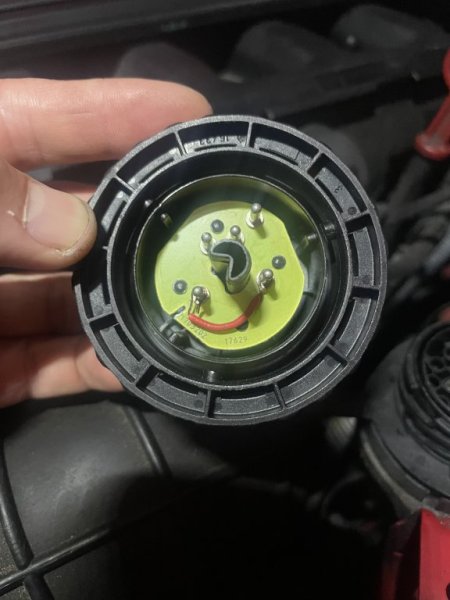

You have to connect these two pins in the engine plug cap in order to read all codes from inside. Otherwise you will just see engine codes and nothing more.Under the dash.

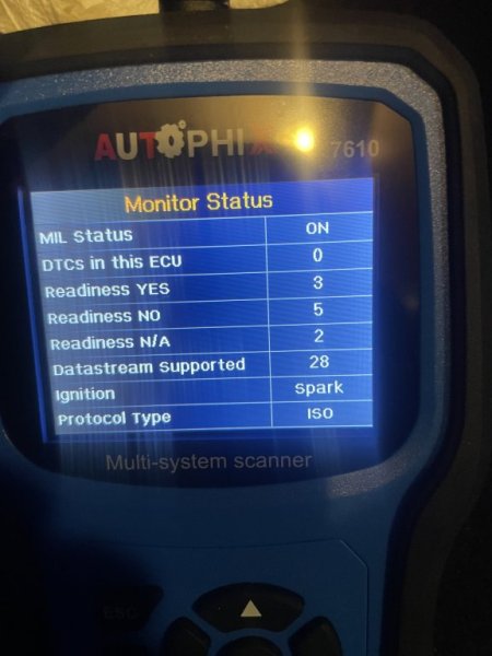

Did you do an I/M readiness test or just scanned for codes? Sometimes the Readiness menu can reveal some issues.
and check the live data if possible, you may see some abnormal negative values there (and check the minus temp in coolant and thermostat)
I will try what you ask tomorrow, thank you for your help!! I will let you know.Speaking from experience I would check
