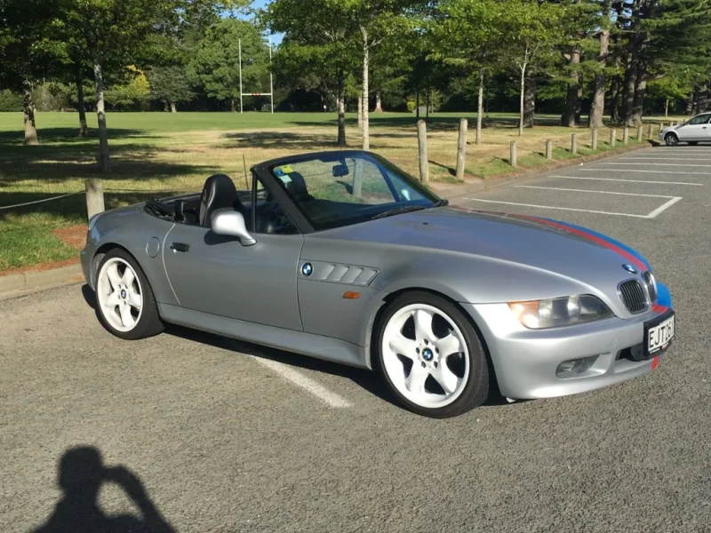

Welcome @SergeGray !
I would say welcome to the M44massive, as you definitely have a plus on the car!
Frankly, at this moment I will keep the car as it is, but I believe that the little devil of the mechanicals will not sit tight...
Enjoy the forum and we will keep an eye on this project.
Dan
Very nice, been looking at this mod for a while it is cheaper than a supercharger. From what i have gathered anything up to 8PSI is ok with standard internals, over that you have to look beefing up the bottom end, lowering compression etc. but at the end of the day 6 - 8 psi should give you nearly 200 BHP, and that should be quite nice in a revvy little number such as the M44. Keep us posted on your progress please...

Will keep you up to date with the progress Dan. Still plenty if stuff i need to do to it.
Hi there, from what I've heard it's actually cheaper to and a lot easier to have a supercharger installed due to the ammount of work and modifications involved, however never done ether work my self. There is a couple of very interesting z3 driving around the city I live in NZ. Ine of them is highly modified and fitted with a supercharger. The owner was kind enough to let me take his z3 for a test drive, it went very well but not as quick as my turbo z3, and mine is running on around 5psi at the moment. Anyway will keep you up todate with the progress and when i get the dyno done will let you know the bhp on it too
