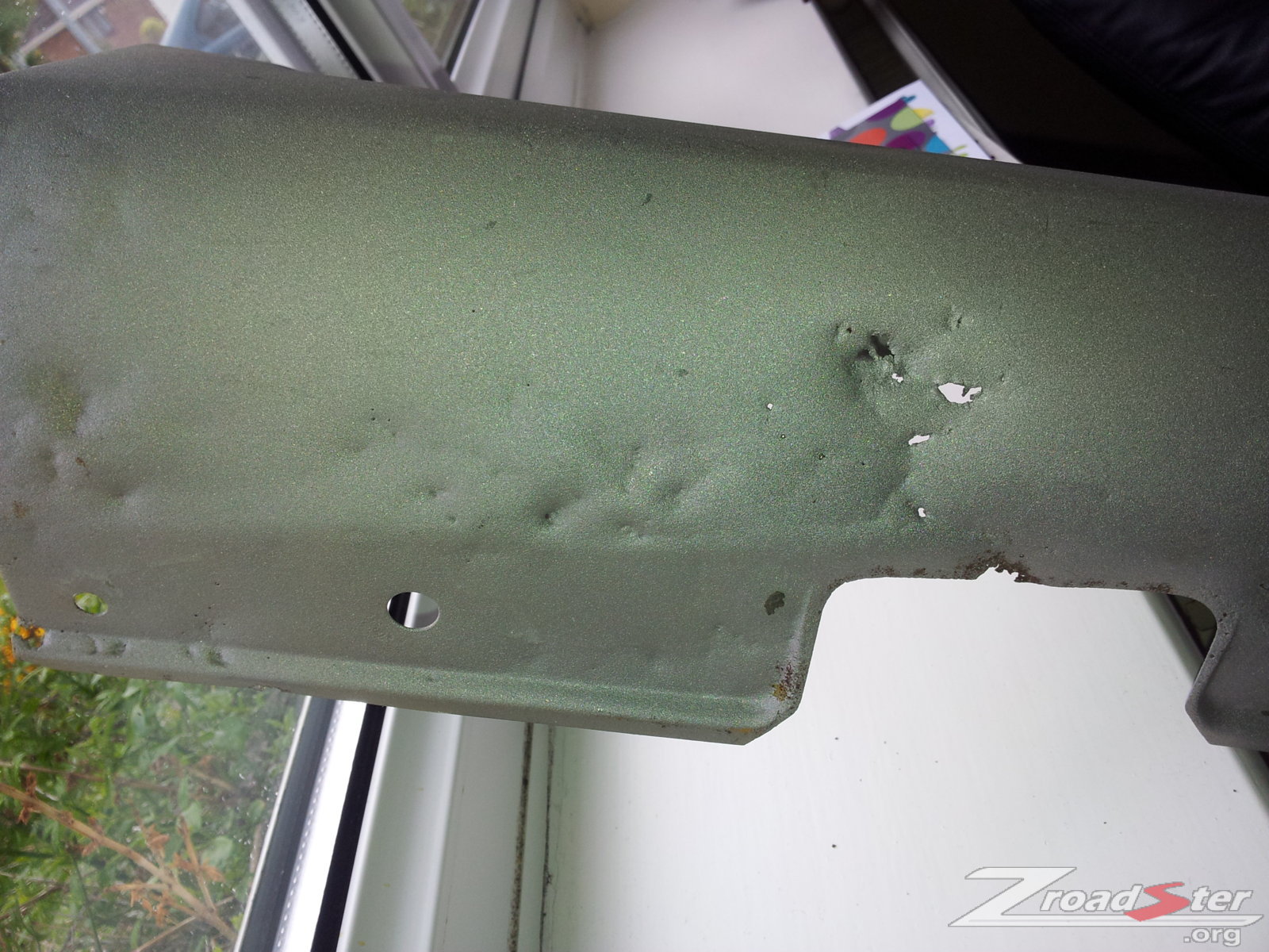

................. Are there any other rust prone areas worth treating while I'm at it?
Have posted this pic before but check inside edge of front wing panels (they come off when you do the sills anyway) . Treated mine 2.5 years ago but a lone pimple has re-appeared :( and needs treating before it spreads into a rash.
