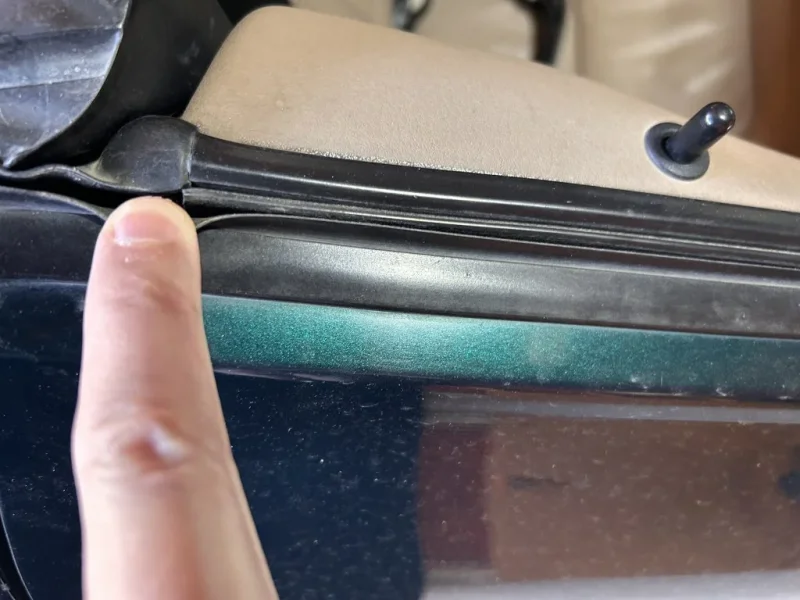

Gave a sharp medium-force push down on the trunk side of the glass as I was pressing the button and it went down just fine!
It still gets stuck the same way but I can make it go down with a push each time so far.
I know it will probably fail completely soon but for now I’ll take that. Just want to drive, not take it apart.
Would squirting wd40 somewhere in that hole be beneficial since it seems to stick on that side? Or would it be pointless?
Got nothing to loose by trying that but finding out why it's sticking and putting that right is the way to go.
WD40 isn't a lubricant, it's penetrating fluid, for loosening stuck fixings mainly.
You can spray the stuff wherever you like, but it will have virtually no effect and make a mess forever more.
