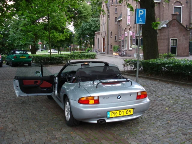

This is mine prior to its hoops upgrade. Under the "parcel shelf" there are two hollow metal tubes screwed in that take the pins of the deflector.
hard top
Dutch Zeds
213
Netherlands
Just to make things even more confusing AMcD, there are two Type 2's with a different mounting distances between the pins.
This is a Type 1 on my car........
