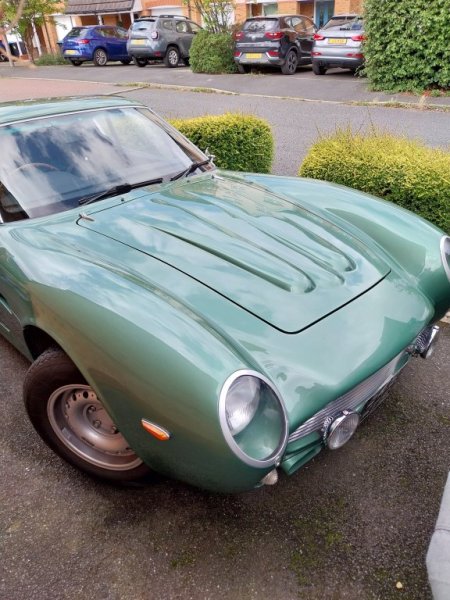

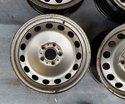

Anyway. Maybe my idea of 17x7 isn't really going to work. Should be looking at 16x7 and tall tyres. something like this. I like the oval holes a bit like the original 507
This is a 3 series F30 wheel. ET31 so will push the rim out around 15mm which is good. But not sure about the bolt holes. 5x120 but I think Z3 bolts might be fatter? Not too expensive. Might buy just one, see if it fits. Stick a tyre on it, 205/65 and see if I like it. Tyre that size will reduce the wheel arch gap by 20mm and give a 6% speedo error - but, as said already, my speedo is 6% out anyway so it'll be spot on... er... m'lud

The ET is 47 so you could add a spacer to move the wheel out. The seller lowers the price for buying 2 or more. A Google search reveals cheaper prices

I used bmw winter steel wheels. The offset is slightly more than original and the ‘rim dish’ looks just right to me.
im sure I saw some with the oval holes when I looked around, but wanted the round holes on mine.

I've ordered one of the F30 steel wheel (oval holes). I'll put a tyre on it and see what I think.
