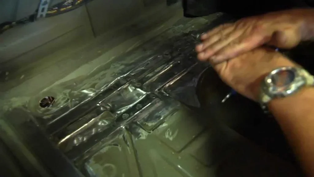

from what I have seen just, he added strengthener plates either side of the channel section, plus underneath it, and then made and welded a new diff mount to that. The strengthener plates were drilled and plug welded just to the sides of the channel,
Even if he fully welded across the top of those strengthener plates, because they are only 3mm thick he will have welded them to the top web of the channel, which is the bit that comes away when the spot welds fail.
Unless I missed something, he now has made a strengthened channel, that will just pull away from the boot floor as before?

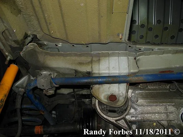

look at the swaged web at the top of the channel below:
What would his repair do to prevent the spot welds separating where the channel meets the boot floor?
In all honesty he has made the problem worse. The Diff. and A/R bar are now bolted to a far stronger piece which cannot flex at all and will likely tear the floor more easily. I'm not sure why he removed the sound deadening inside the car either unless he welded something inside which we did not see. Also I would have had something covering the aperture into the boot space too.
Yes exactly, unless he has done something with the top part, there is likely to be more pulled welds now after that track driving
To me a proper fix is this :
cut out a strip of the boot floor along the inside edge of the channel, and weld the full length of both edges of the channel to the boot floor .
Then weld the strip back on again: (not ideal photo but you get the message)
then strengthen the channel and diff mount if needed, spot weld fails seems more common than diff bracket fail
