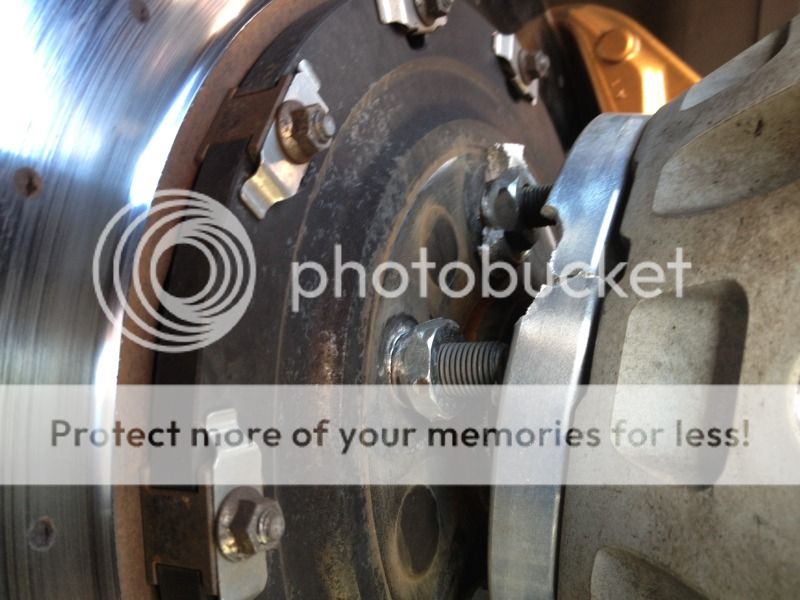

Not really, you have 5 holding the spacers to the car (hub) and 5 holding the wheel to the spacer as you've introduced another joint face.
same amount of joint faces as the bolt though type with double the amount of bolts. That is what I am comparing with, not versus a non-spacer setup
There's my point exactly Brian, you have to torque the wheel bolts correctly. So now you leave them on all the time, is that because you feel that they will be ok or that in a track environment it's not so critical if you loose a wheel? I assume that when you say you see stacked spacers up and down the pit lane, that means people still take them off because they don't trust them either, but then they're happy to trust them on normal roads.
Loosing a wheel is critical no matter where you are :eek:, I guess I was trying to say I have never had any issues on track with them so I leave them on.

Oh, sorry, I see what you mean. Using composite spacers isn't on my list of good ideas. If you need 10mm you need to fit a. 10mm spacers not 2 x 5mm.
I agree with what you're saying Pete, but your wheel is still only attached to the spacer, not to the car. The spacer itself is only attached to the car not the wheel. Also you surely can't use that type if you only needed, say, 10mm spacing as there wouldn't be enough hold for threads or to hold a bolt head from the rear side l don't think. Just a difference of opinion, I'll stick with what I trust.:)
All good Pete, but how thin can you go with bolts on spacers, do you happen to know as I'm curious?

Re thickness of spacers, having looked at my 25mm ones I would say that was the minimum thickness for bolt on, There is an amount of metal left after counterboring and countersinking but I wouldn't be happy with anything less than what was on these ones.

I had the same bolt on extending bolt spacers in my mini and snapped many a stud not good at allo_O
Yes, that's what I imagined mate.Scary s***.

I still have an aftermarket dashboard from my old mini with lots extra smith dials, switches and lights up in my parents loft. I removed my front wheel spacers due to a snapped stud on my mates ending up with the front wheel flying off a frightens experience. Anyone did the starki and hutch paint job on a Marina :D
