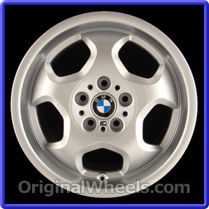

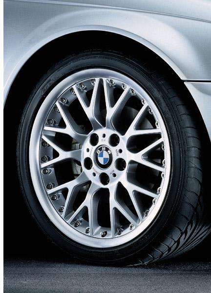

Hello! I´m looking for some rims with a more agressive look. These are what I have fitted today. I´d like to have more spokes (something like the picture below) The only issue is that I dont know which size of rims fits my brand new tires. The tire size is 245/ 40 - R17 (Rear) And 225/45 R17 (Front) a Any help or recommendations would be appreciated.

Style 78's like above (but one piece not splits) usually come in a staggered set up and the rears will take the 245/40 tyres. The fronts are 7.5 width and usually take a 225/45/17 tyre and the rears are 8.5 and take a 245/40/17 tyre.

Are the rims I have today stock for my 97 1.9?
Looks as if they were an option for the Z3. They were mostly found on the E36 M3, called M3 Contours or Style 23.

This shows vehicles that had the option of them being fitted. The 1.8/1.9 is on there but it looks like they were the same size all round therefore should have tyres the same width, probably 225/45/17. You may have the wider set fitted to the rear which accomadate the wider tyres, unless they have the wrong tyres fitted or are stretched. You would need to look at the width of the rims which should be stamped on the back of the wheel.
