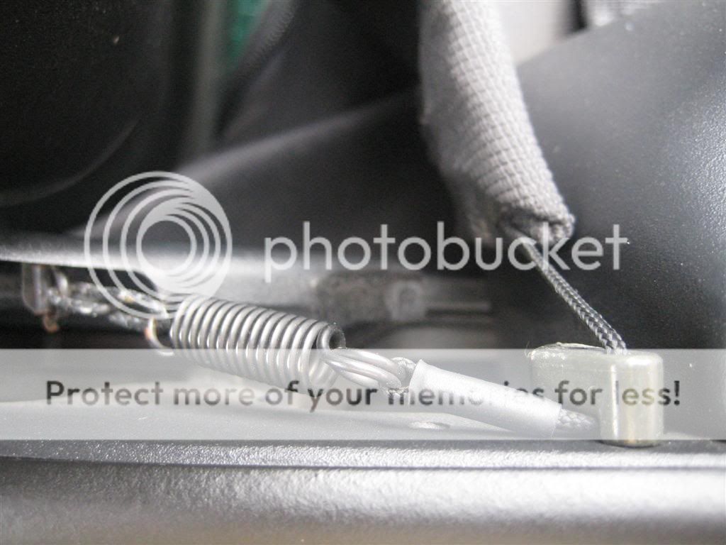

What is this for, or should i say what should this do?
on each side of the roof a small spring on both sides only attached to one side.
sorry not a great photo, will take another if needed.

It's the tensioning spring for the roof lining to keep it taut.
The brass crimps which are hiddedn by a heat-shrink sleeve eventually give way, the cord disappears and you're left with a dangly spring.

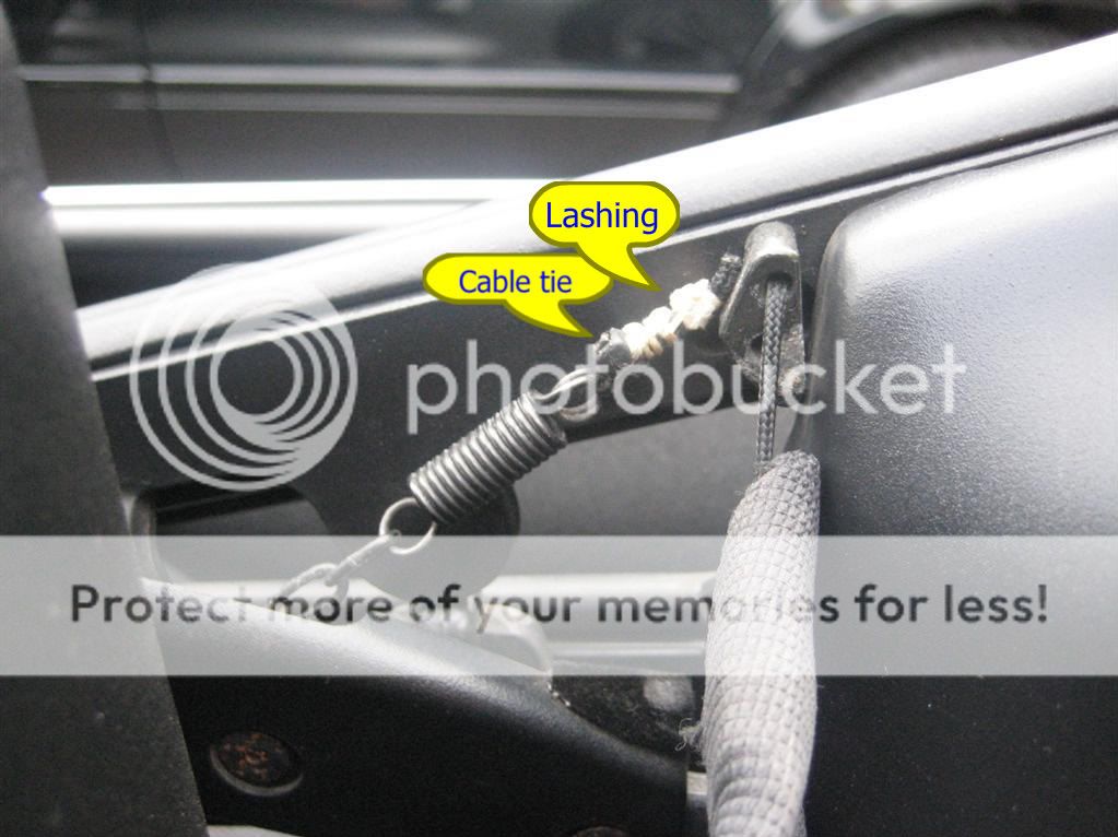

Have a look at these pictures:
Originasl LHS
Repaired RHS
