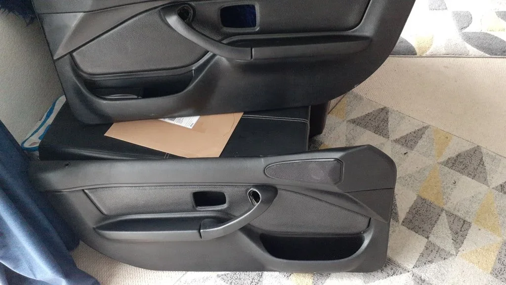

Picked up a pair of very clean door cards with non broken handles off eBay for a bargain price.. noticed they have two sets of speakers in them.. I assume it’s from a car with the HK upgrade? It’s got two sets of wires, guess the standard loom wont have two sets of connectors?

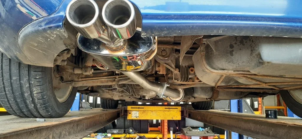

Lashed out new powerflo exhaust system.
Original exhaust 23years old 🙂.poor condition. To much work to weld up now.

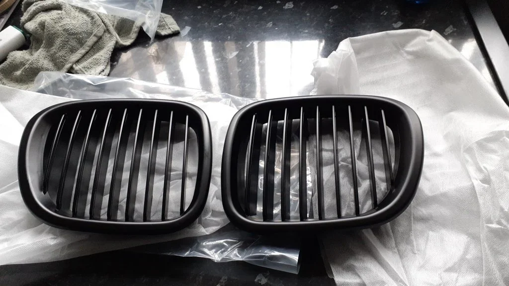

New Black grilles

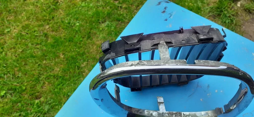

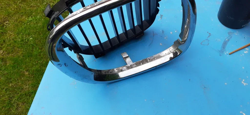

Let me know your technique for getting the original grills out.
Had a black set sitting for 2 years.
Grab the grilles with your fingers and pull.
Paul&Di
Aug 21, 2022
86
Pretty much as Tony says.i used a small screwdriver and pressed the clips from the inside. At the same time teasing it out from the front. I will put a photo on so it looks more obvious. I got them out undamaged that way.
Paul&Di
Aug 21, 2022
86
I put the gilles the wrong way round 😄🥸hope you get the general idea.
