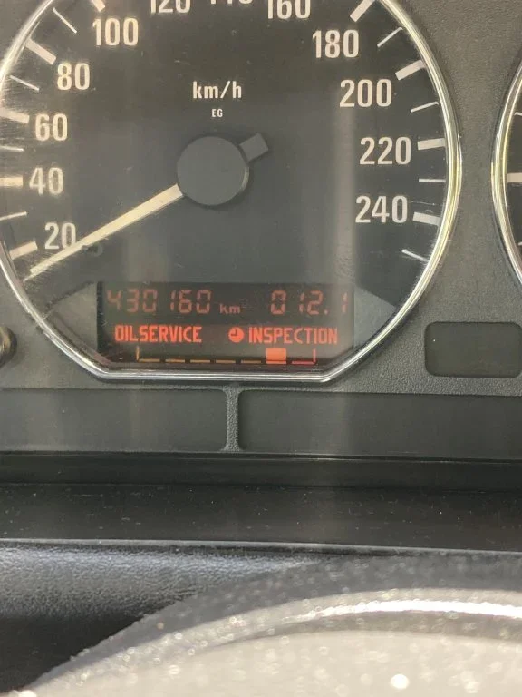

I had an oil service 4 months ago and the service lights were zero’d out.
I have driven since only 4,000 miles and all the green LEDs are gone and the "amber" & “oil service” lights are showing.
Does this make sense?

The only thought that comes to mind is that maybe the service interval has been coded to a lower milage, to check this you will need to use NCS Expert to read the coding menu and look for service interval settings to see whats coded in. Probably find what you are looking for in the instrument cluster module. How long have you had the car and have you been changing oil before the service reminder lights up? And of course had the service interval light reset when oil change has been completed.

I’ve had the car for 15 years. From 167k km to 430k km today. 🤓
I personally reset the service lights on the 15th of Feb this year. I have been servicing every 6-9 months (if I recall correctly when 1-2 green LEDs)

Sequence is oil service, inspection one, oil service, inspection two and so on. :thumbsup:

Sorry - I don’t understand your answer.
According the the pic above - what should I be doing? Until now I took it in and I assumed they just changed the oil and air filter and “sniffed around” to charge me for anything wonky.

Inspection I is an oil change and inspecting under the car for wear and damage, i.e. leaks, brakes, and suspension componets.
Inspection II which in addition items listed in Inspection I, it specifies replacement of:
Air Filter & Fuel Filter
Change transmission & rear differential fluid
Brake fluid every 2 years,
Coolant every 4 years (3 years for M versions) from production date,
Spark Plugs 1997 - 1998 and M models every 60,000 miles (100,000 km)
1999 - 2002 every 100,000, (165,000 km)
Oxygen sensor 1997 - 1998 100,000 miles (165,000 km)
1999 - 2002 every 120,000 miles (200,000 km)
At 430K you would be at the mileage to replace the spark plugs, Oxygen sensors, and the coil packs if not previously replaced. Any of the control sensors (cam, crank, and MAF or MAP) if not previously replaced are at least 20 years old and subject to reduced effectiveness or failure. The other items would be rubber hoses and boots our cars are getting to the point where time will have an effect on operation and maintenance. My car has 122,000 miles (200,000 km) and as I have gone through it I have replaced most of the items mentioned to ensure it is about enjoying the driving experience and not worrying about the next failure.

I notice that the little clock is illuminated indicating that the brake fluid needs changing, and the light resetting. As far as I know this is just a time based system of two years.

How does the light differ between inspection I and II?
