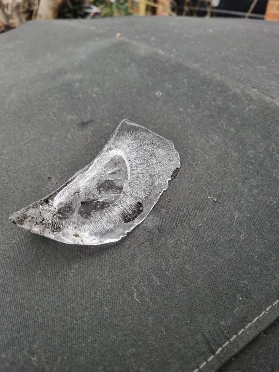

Thanks to all the advice. I managed to clear the small hole there. It helped with the cold weather ☺. When I went out today to clear it water has got frozen and came out like an ice cube (see attached photo).
Then I got hold of a ballpoint pens tube inside and just yamked it and got it all cleared.
Happy days

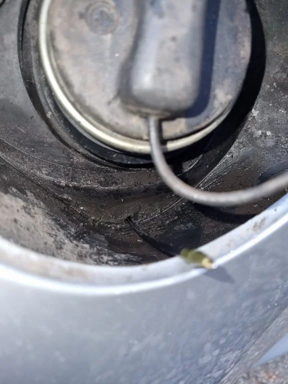

Sorry to push an old thread. Just driven to Leicester after a couple of weeks of serious road mileage and have made an interesting observation.
I've been an idiot and spilled a bit of Shell's finest 99RON fuel into the area around the filler cap. I say that as all the grit, crud and gunk that used to block the drainage hole has... Largely gone. Instead there's a few granules of dessicated carbon/mud/crust and a petrol odour. Very localised.
I can only assume that petrol is a solvent and that it's degraded this gunk in the 90 mins since I filled up and hit the motorway. I've had a look under the car and there's a little tiny patch of dark gunk on the tarmac underneath. The drainage pipe had a droplet at the tip. No sign of any fuel leaks elsewhere. Selfie camera mode remarkably useful!
I'll keep tabs on the situation before driving anywhere else, but I don't think I've any leaks. Just thought I'd share this in case anyone has seen or done anything similar.

There is a tiny drain hole in the rubber surrounding the filler neck. These block and keep water standing in the rubber surrounding the filler neck. The fuel you spilled possibly cleared a blockage, usually you have to poke something like Strimmer line down to clear it.
overthehills
Nov 17, 2018
46
Shrewsbury, Shropshire
Cheers for this, Tony. I'd previously only heard rumours such a hole existed! Amazing if that's what it was although probably not a treatment I'd recommend. Hopefully it was just a clumsy spill and not something serious. All signs point to my own stupidity 🤣
Yes, there is a drain hole. Honestly.
