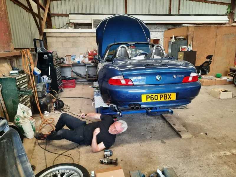

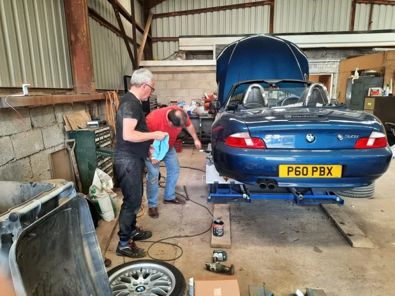

Popped down to Zed Shed West today with @mid life crisis . @PHILIP BAXTER had come up to do some fettling on his car ready for next weeks Lakes and Peaks run. @Nodzed was on hand to inspect the quality of his work to make sure it was up to standard.
