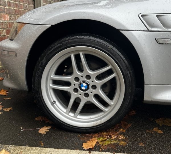

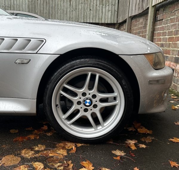

Uneven front suspension. Off side/drivers uk side was lower than near side. Was causing an issue as was so low. Took to garage. They were baffled as to why but replaced both sides front springs and shocks.

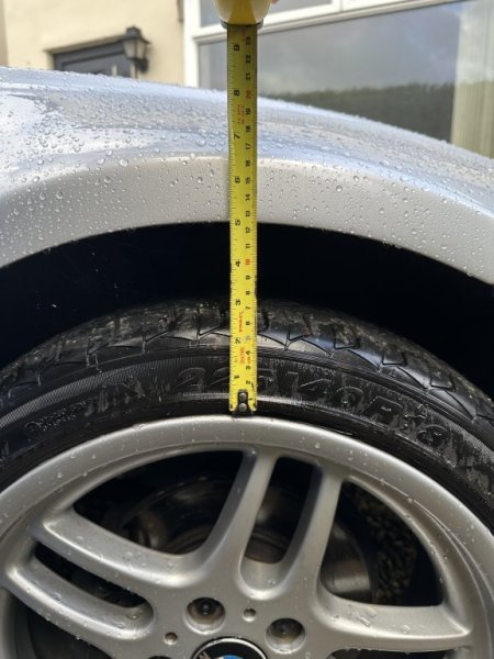

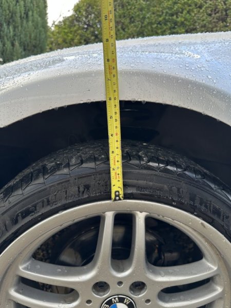

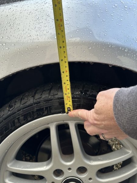

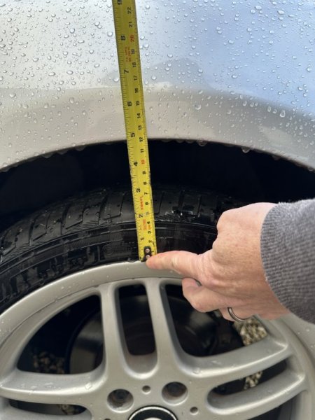

pics show results! Now both much higher but same problem persists. Near side still much higher. It looks ridiculous really. Garage says drive it to settle them but can’t see how that will even it out. They are happy to have it back in but they do not know what the issue is.
What do people think?
