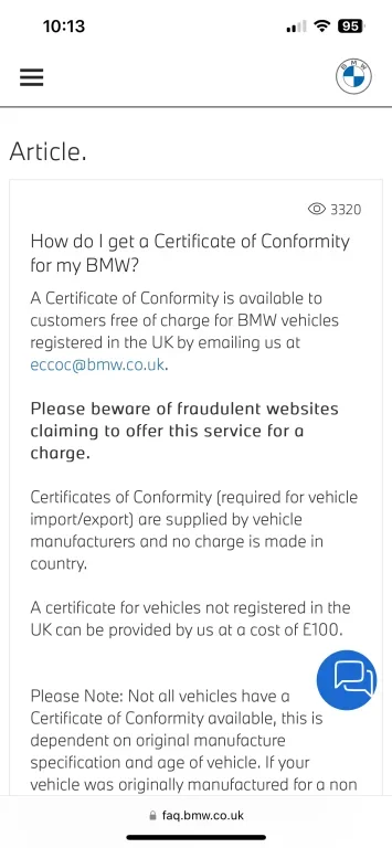

I applied to eccoc@bmw.co.uk asking for my cars conformity certificate and gave them my vin. They sent me an attachment duplicate at no fee.
A Certificate of Conformity is available to customers free of charge for BMW vehicles registered in the UK by emailing us at eccoc@bmw.co.uk.
You need to tell them Reg Number and Vin of the car, mine took about a week to be emailed back to me.
Please beware of fraudulent websites claiming to offer this service for a charge.
To get the emissions levels added on to your V5 you have to send your V5 and certificate of conformity to DVLA in Swansea or complete the required form plus certificate attachment online. Can't find the DVLA link to do this online.
BMW I believe do not charge for a duplicate CofC. At least the didn't when I applied at the end of last year. The application is done online, I don't have the link readily available, hopefully someone on here who has applied recently can send you that. Beware websites offering a similar service for a fee.
