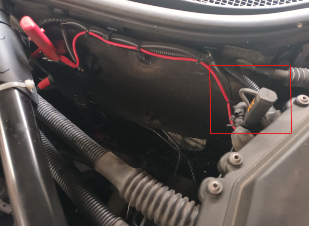

Reviving this thread.
one of my cars has an AGM battery and I am wondering if I need a special AGM charger for that.
I do have one that has an AGM button, but is a very big one and would prefer to use my good old CTek in hibernation mode as it seats neatly under the bonnet (hood) and I can keep it shut when the car is parked.
Also, the instrucrions on how to charge that make zero sense to me.
Why do all that and not just use the designated spots (positive on battery and negative on the strut tower)?

All this seems quite confusing and pretty "black magic" stuff. Up to today, it was, pop the bonnet, connect, forget.
Why do this ritual and why can't I use a simple charger for AGM?
